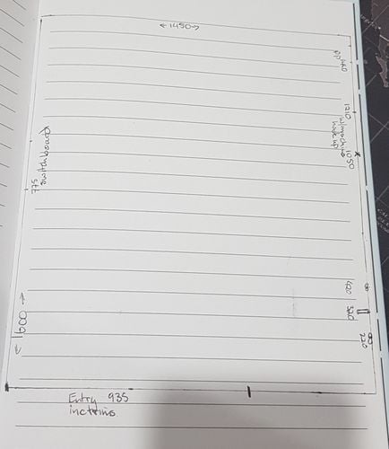

This is a rough sketch of the space. It measures 1600x1450, entry is 935 including the door trims. The switchboard for the house is also in here, as is the manhole so I can't put anything permanent along the lefthand side or along the back wall lefthand side (most I could go out from the right is about 700mm). The sink is a pretty standard steel tub with cabinet. I generally don't use the sink and cabinet is not the best storage solution so I'm wanting to change that.
My initial thoughts are this - install a benchtop running along the righthand wall, removing the cabinet and sink. Install a smaller round sink similar to this but hopefully in black and flush mounted. Replace the laundry taps and the washing machine taps and have the washing machine against the far wall. I'm thinking a 600mm kaboodle cabinet under the sink with white doors.There should be enough left of the offcut from the benchtop to do a sink inset cover thing, and space between the washing machine and cabinet for laundry hampers. I've also already removed the laundry door, since we never shut it, it makes the space feel smaller and it was quite a few bangs and dents on it.
I feel like wall cabinets would enclose the space more, so I'm leaning towards one or two shelves above the bench running the length of the wall for additional storage.
I'm in two minds on what to do for the backspash. I definitely want it to run the length of the wall, but I'm leaning towards stick on tiling at the moment. I would like to eventually (in 3-5 years most likely) have the powerpoint moved down below the benchtop and the washing machine plumbed directly, but my budget doesn't allow for it at the moment. It seems a bit of a waste to tile when sections will probably need to be redone at that point anyway.

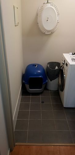

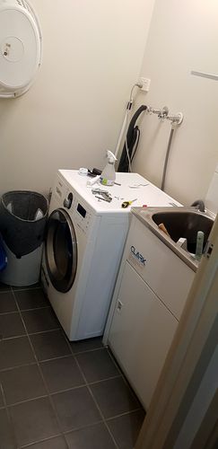

They aren't the best photos @redracer01, the linen cupboard is on the other side unfortunately but here you go!
There's a shelf in there above the sink that I've put in as a temporary measure as well.

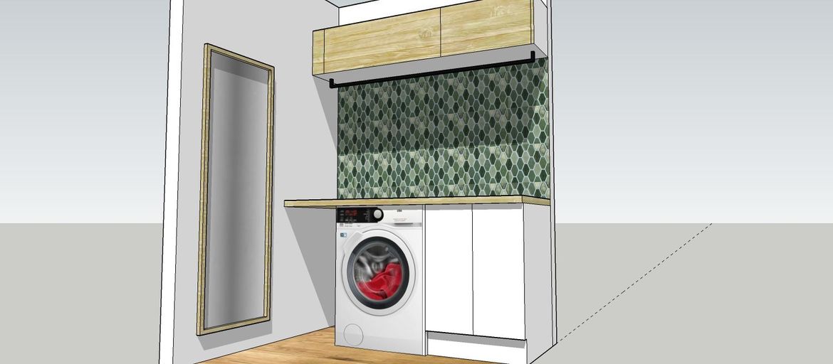

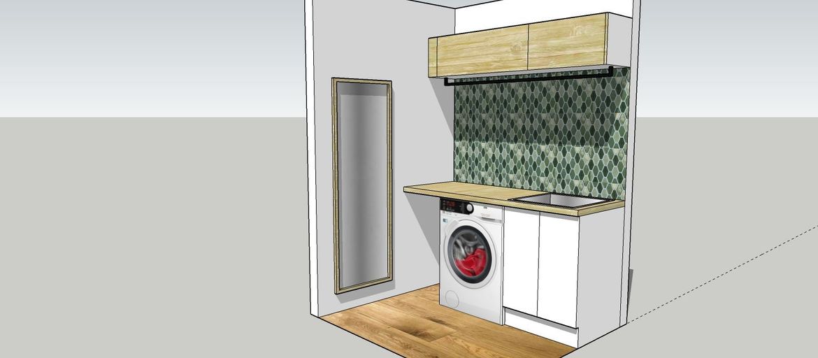

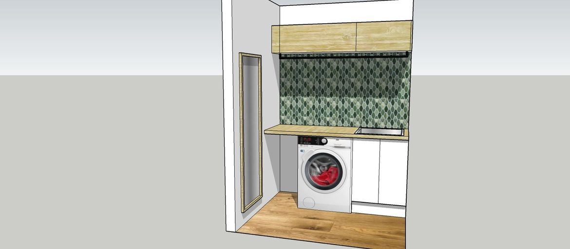

Here's my suggestion for the make over. My only thoughts on this is perhaps if possible place a sun tunnel so that sunlight will shine in this room.
Cheers!
Red

Thanks so much @redracer01 that looks awesome! I'd actually considered a mirror but wasn't sure how it'd look, so it's great to 'see' it work haha. I love the hanging rack under the cupboards too - what tiles did you use for the backsplash? A skylight would be fantastic and is in the 'future plan' so to speak. :wink:

I saw the stick on at amazon - green stick on tile.
