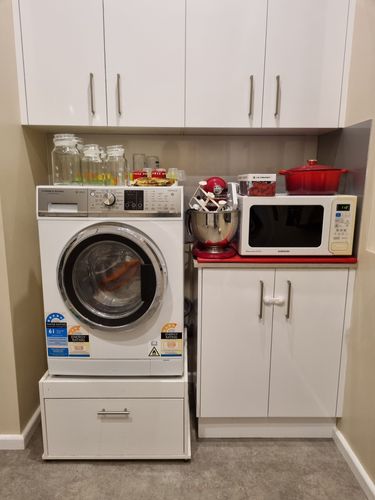

Hi, I currently have a washing machine and a laundry sink (and cabinet) in an alcove in the kitchen. I believe that it is generally a requirement to have a laundry sink, but that people have been allowed not to have one if there is another sink readily available (e.g. if the laundry area is co-located with the kitchen or bathroom). Can anyone confirm this and/or offer advice on replacing the laundry sink with a dishwasher? Thank you!

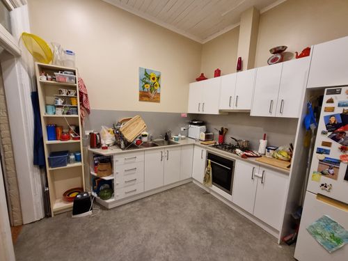

Hmm. Thank you. I can understand that logic, but as you can see from the photos, I wouldn't throw any dirty water down the laundry sink as we have covered it and the microwave is sitting on top! I eould take dirty water to the bathroom next door and dispose of it there (or outside).

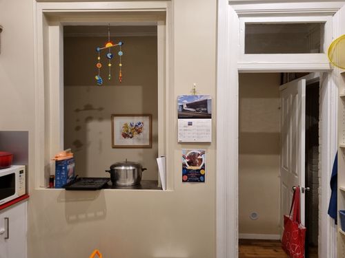

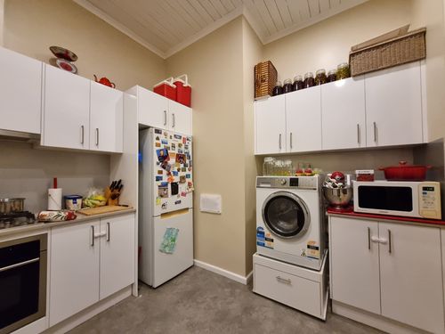

So, here are some kitchen photos. For context, the house is 119 years old. The section to the left of the washing machine is an enclosed fireplace cavity that we would like to open up/use at some point if possible.
The wall to the right of the microwave has what we call the "pass", or a servery window (originally an external window) that again, we would like to preserve if possible. But we are open to ideas and suggestions!

Hello @mhlane

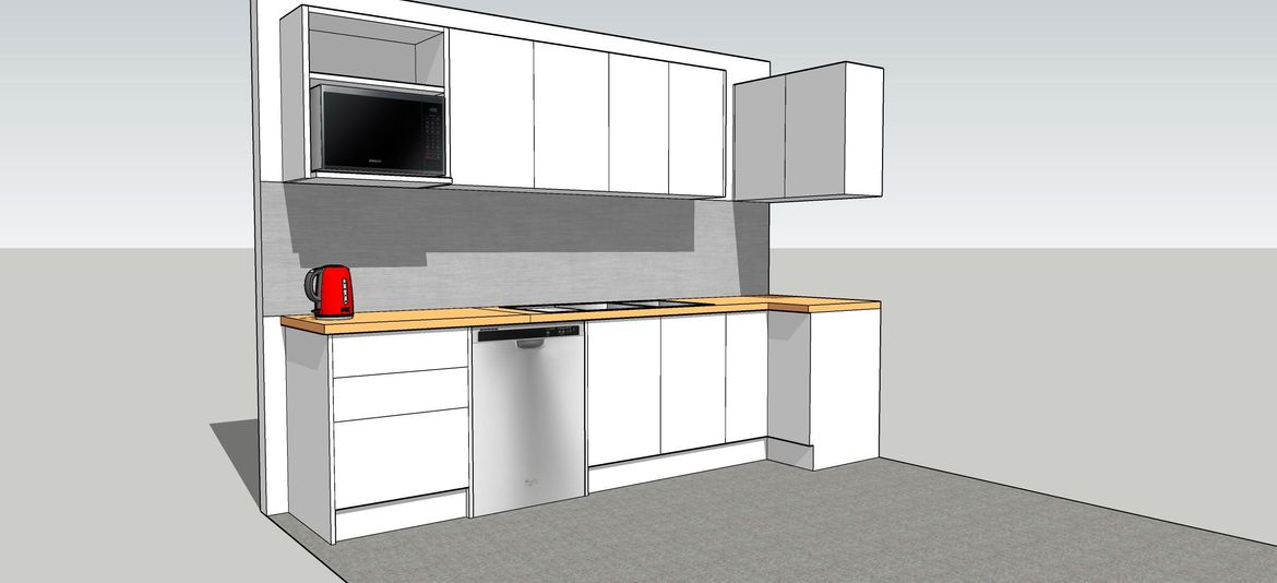

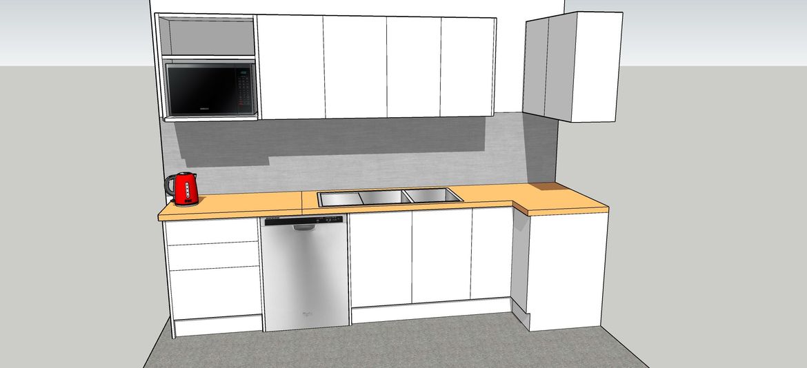

Thank you very much for the kitchen photos. I would like to propose a re-orienting of the funds you were about to spend on your laundry tub project. Looking at the third photo of your kitchen, I recommend removing the 450mm 4 drawer cabinet, the 250mm open side cabinet and your open pantry. I suggest replacing them with the dishwasher a 600mm 3 drawer cabinet, a microwave cabinet a 900mm and 800mm wall cabinet.
The wall cabinets will now serve as the storage area, your microwave can now be taken off the laundry tub and you get a much larger drawer for plates and accessories. The benchtop of course will need to be linked to your existing benchtop. But once you have enough funds for a benchtop revamp you can replace the existing split set.
I've placed a sample sketch below to give you an idea of what it could look like with the added cabinetry. Please tell me what you think.
If you have any other questions we can help with, please let me know.
Thanks @MitchellMc, but opening the fireplace won't help as it is half obscured by the fridge (which has nowhere else to go unless we do a complete renovation.

Thanks @EricL, I appreciate the diagrams (very cool!) and I hadn't thought of that option. It is also a possibility, but - and sorry if it wasn't clear from my photos or description - there is a doorway to the left of the open pantry, so we couldn't have cabinetry to the same depth as the current cabinets or it would obscure entry to the kitchen. Also, we don't currently have any upper cabinets on that wall (though I'm not averse to it), and again if we were going to remodel that bit, it would probably be better to do a bigger renovation to address some of the other issues (eg benchtops too low for tall family, poor use of space in laundry area, desire for hanging laundry section behind doors, any opportunity to reinstate original stove, wall oven rather than under bench oven, drawers rather than cupboards, etc!)... I had hoped that replacing the laundry sink with a dishwasher might be a quick interim step to save backache when washing up bit short of getting a counter top dishwasher (and needing to find it somewhere to sit!), I'm not sure there is any workable option.

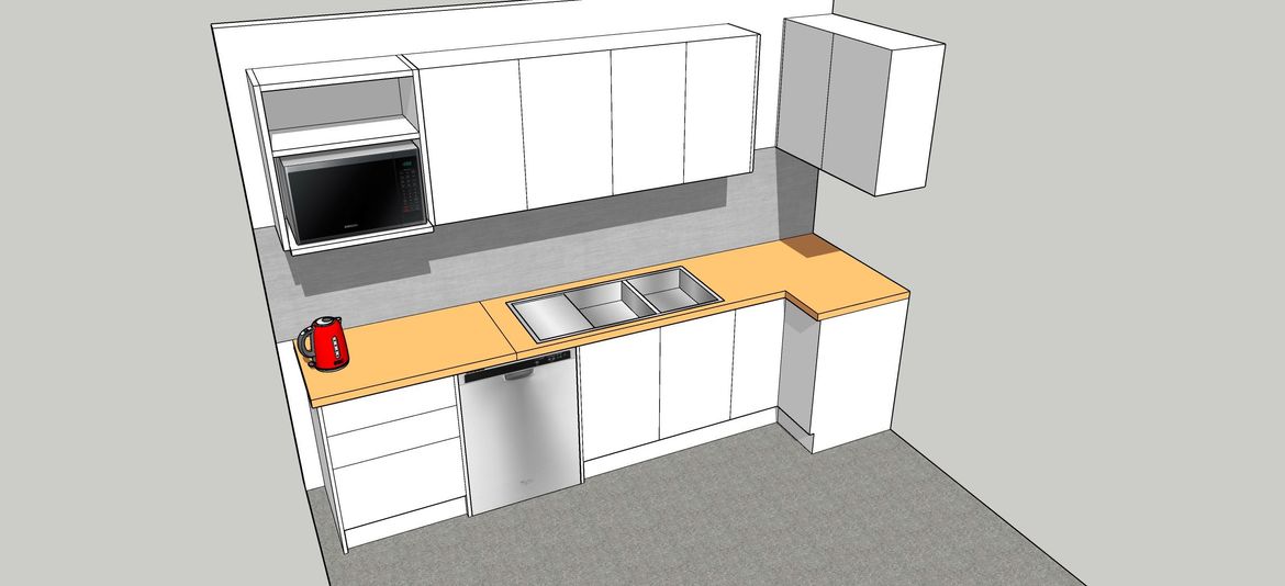

It occurred to me that you do have one more option. I propose removing the 4 drawer cabinet and the 250mm open side cabinet. This will give you enough space to put the dish washer in. Everything else will stay the same except for the addition of 2 x 600mm 3 drawer cabinets in the middle which will serve as your island.
The best part is that you can construct this island with wheels at the bottom, which will allow you to move it out of the way if you want to.
I've placed some sample sketches below to give you an idea of what it could look like.
Thanks, I really like this option. It would be good to have a dishwasher near the sink too! So we will explore it a bit more. Thank you for your help!
