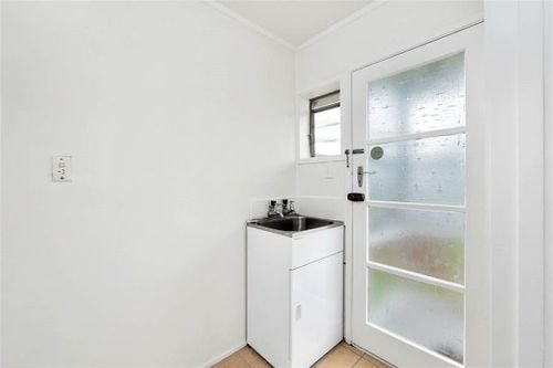

First Home owner where the previous owner has done a very rough renovation.
The house has very little storage so can’t install dishwasher in the kitchen. As we don’t want a dryer there is room next to the washing machine however I wanted to use that area for a pantry as the kitchen doesn’t have a pantry.
Question is to save on space and as I’m replacing the laundry tub anyways can a drawer dishwasher be installed as part of the replacement laundry tub? Sorry if this is a dumb question fairly new to all of this. I won’t be doing the install will hire someone but need to understand if this is something that can be done. Laundry area also happens to be the entrance to the house. Thanks in advance

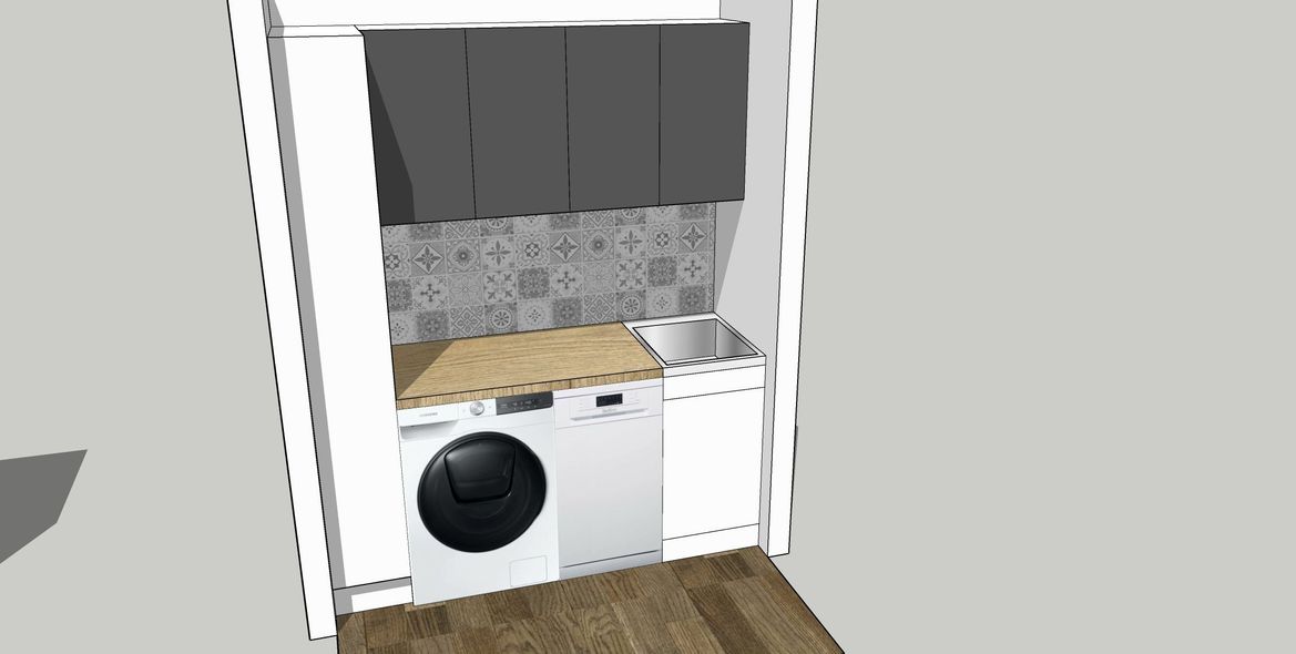

I've placed a possible layout of the room, please tell me what you think. If you wish to see it in another configuration, please don't hesitate to let us know.
Hi Eric
thanks for the quick & detailed response. The washing machine that’s going in there is this one: https://www.harveynorman.co.nz/whiteware/laundry/front-loaders/samsung-9.5kg-front-loading-washing-m...
i haven’t picked out a laundry tub yet as I was waiting to see what would suit best
Would you be able to do a mock up option one? With a 300mm pantry please
Thanks 🙏🏾

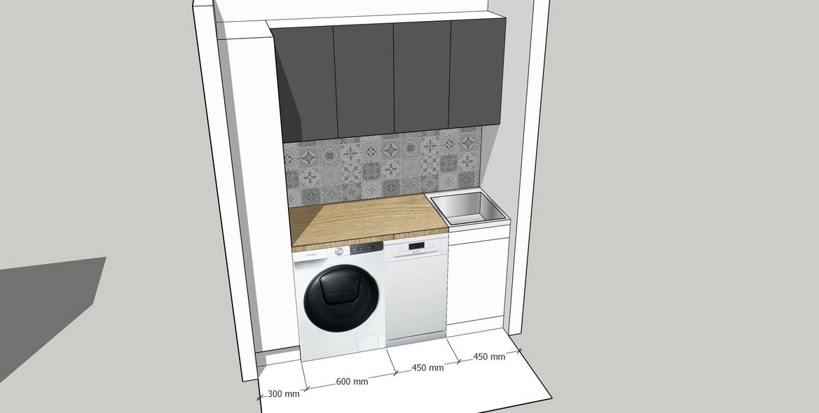

Hello @FHOAuck
My apologies for the late reply. Below is the revamped drawing with a smaller laundry tub, compact dishwasher and your choice of the washing machine. Please keep in mind that you have the option of having a benchtop over the machines as they are lower than the height of the laundry tub. The measurements provided are for reference only, please check your appliance to make sure it will fit into the provided space.
Wouldn't it be better to have the washing machine next to the tub and the dishwasher next to the pantry cupboard? Half the cupboards above could be laundry stuff and the other half next to the pantry could be kitchen items. Then the dishwasher/pantry would look like part of the kitchen when viewed from within the kitchen.
You can have whatever orientation you like to the appliances @Lindia. @EricL might have chosen to put the smaller appliance on the right as you'll find it difficult for the dishwashers hoses to reach behind the large washing machine to the sink otherwise. That doesn't really matter, though, as the plumber can just attend to that when installing them.
