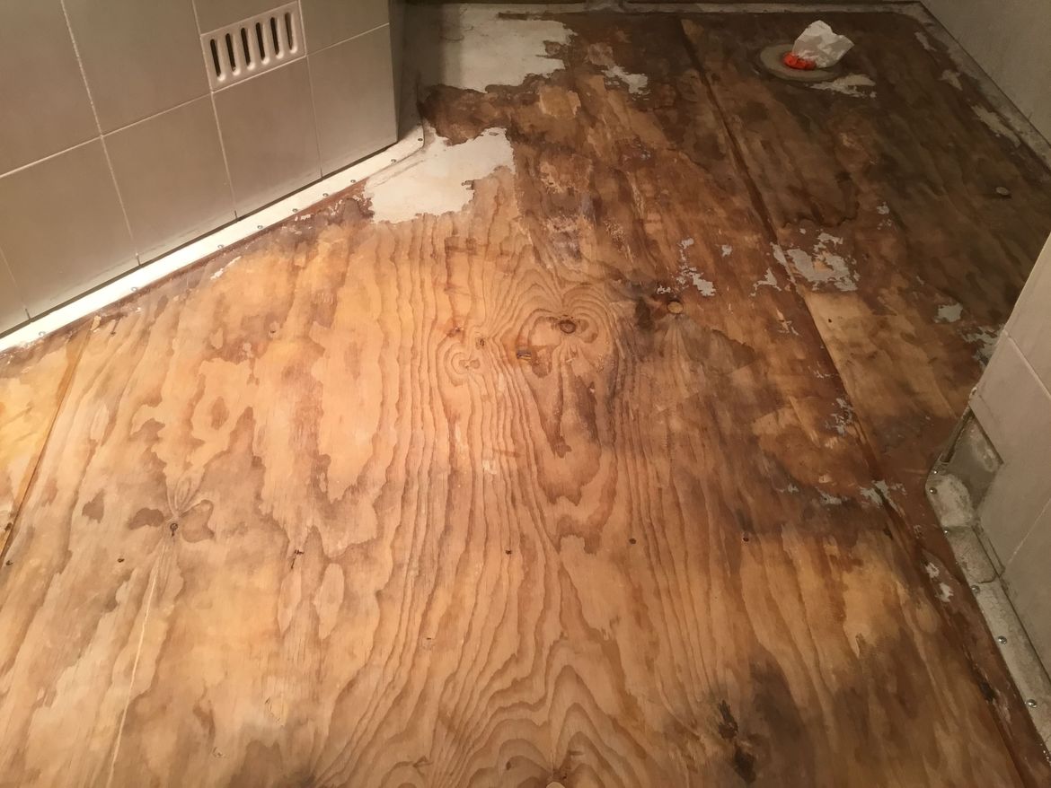

Can we tile on top of waterproofing ceramic tile underlay without sand and screed?
Lim1
Upstairs bathroom floor that with plywood subfloor.ECF67A55-EB37-40D5-ABF8-9AF3E81560AB.jpeg

Sand and screed are often used to create a fall so that water flows into the waste of the shower. Generally, this is often the case when you are tiling the floor and it serves as the shower base. However, if you are using an acrylic or polymarble base then no screed is needed as these bases are formed with falls built into them.
At this point, I recommend checking the rules and regulations on bathroom waterproofing with your local council. Installing the tile underlay and waterproofing it might not be sufficient. There could be fall requirements or that this type of installation can only be carried out by a registered tradesperson.
