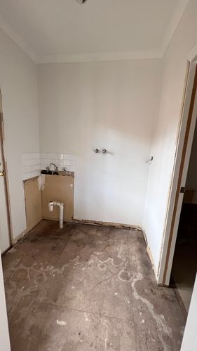

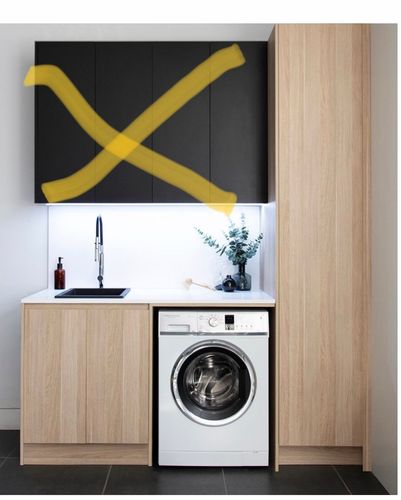

Hi, we are looking to update our laundry. We wanted a benchtop to cover the washing machine and have a sink, and
a tall broom cupboard at the end. I have included a photo of what we have and what we would like to do. Unfortunately we cannot move the washing machine taps as it is a brick wall behind. Is it practical to drill holes in the benchtop to allow access for the washing machine to the taps? (Floors are getting repaired and tiled next week)

The good news is that it is possible to drill through your bench top to allow your washing machine hoses to connect to the laundry tapware. Please note that this applies to laminated and timber benchtops only. If you are using stone or quartz tops, you'll need to get a stone mason to cut the holes for you. My best advice is to invest in a good hole saw kit or blade so that you get a clean and precise cut.
My only other tip is to test the fitting of the washing machine and make sure that the outlet hose is tested properly before fitting and that the inlet hoses are positioned correctly so that you can push the washing machine as close to the wall as possible.

Would the drain pipe just go through the cabinet with the sink?
Thanks.
Afternoon @KDMelbourne
Yes and yes
When i retrofitted my Laundry I cut a hole in the bench top to allow for the water hoses to come through as I had the same issue.
I also cut a hole in the side of the cabinet for the waste from the washing machine to go to.
Here is my project if you wantto have a look Laundry retrofit
Things to note
Make sure the hole is big enough for a larger hose/hoses if they are installed at a later date and also that the head of the hoses fit through (Mine almost didnt)
Leaving space around the washing machine in case the next washing machine was larger.

As @Dave-1 has mentioned you'll need to drill into the side of your laundry cabinet to allow the exit pipe of your washing machine to pass through. Please make sure to read the instructions for the correct height placement of your washing machine exit hose.

Great advice thanks! My next question is whether there is some kind of grommet available that would be big enough to use in the new hole (I calculate about 40mm in diameter) - much like a pc cable grommet but bigger. This would tidy up the hole and also protect the exposed internal chipboard from spills etc. I would appreciate any thoughts.

I had the same thought but in the end I left it as is. I figured there is no movement and also the washing machine would hide the hole.
It would be more professional look I would say ![]()
