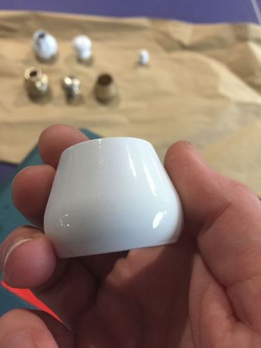

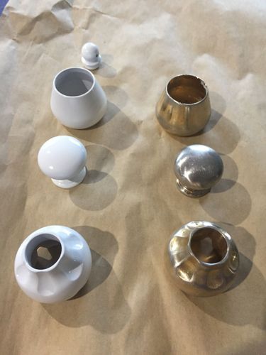

just have it a go
- used dulux metal shield etch
- dulux epoxy enamel gloss white
24 hrs later hard as a rock and I am going to wait a week and let it sit.
Can an anyone recommend a clear coating? Want to make sure that it is compatible to go on top of epoxy enamel.
It will be interesting to see what it looks after a year but as you see from the quality of my taps I am not making the situation any worse.
Kylie
Re: Can you spray paint bathroom tapware?
That is an amazing finish you've achieved there @sebiboo!
Epoxy enamel topcoats such as the one you have used are in themselves a tough coating. It would be correct to wait seven days for them to achieve maximum hardness. There is no clear coat that would provide additional protection or be harder than the epoxy enamel paint itself. You might like to do a couple of additional coats after achieving coverage to provide further abrasion resistance.
After seeing the high quality of finish you have achieved, I'll be eagerly awaiting any feedback on their durability. Many thanks for updating us on your project.
