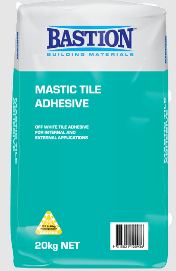

Can you use Mastic tile adhesive in a shower?
itsme12p
Is this
https://www.bunnings.com.au/bastion-20kg-mastic-powder-adhesive-tile_p0273639?store=6439&gclsrc=aw.d...
fine for tiling a shower?
keep in mind its cement based
Re: Can you use Mastic tile adhesive in a shower?
Hi @itsme12p,
Yes, the Bastion Mastic Powder Tile Adhesive would be suitable for tiling your shower.
You may have come across advice suggesting that mastic is not suitable for use in showers due to concerns about organic compounds. While that may have been true for older products, it's not the case with modern cement-based mastics. These do not contain the problematic organic compounds that were once an issue, making them perfectly safe and appropriate for use in wet areas like showers.

Thanks for the reassurance.
