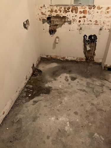

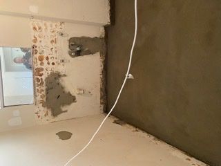

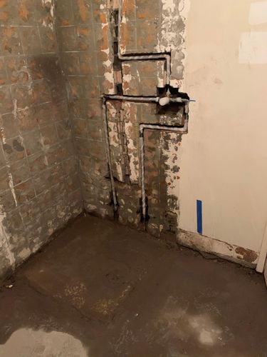

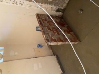

Thank you for your advice it is the best solution for me to create a vanity for a basin and to house the washing machine underneath too. My planned reno of the bathroom in stages first with the shower (unsealed tiles causing damage) was changed 10 days ago. The contractor said the whole floor needed demo, he was right but this has put me in a budget bind. “1970’s pipes are not my friends”
Here’s my ground floor apartment. I’m half way through the tiling process, nod to Bunnings for frantic customer assistance, that vanity area I wanted just a floating cupboard, space hidden washing machine but too expensive and old medicine cabinet I’ve no idea...wasn’t expecting this!
