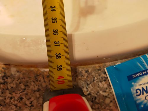

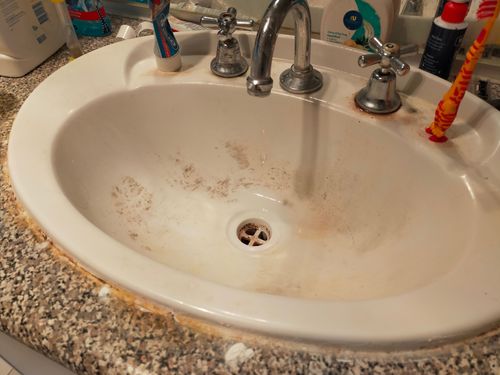

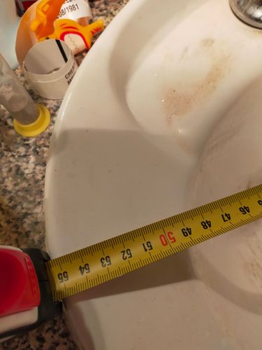

Hi All,

Hi @calccom21
The basins that are very close in the sizes you mentioned are the Estilo 550 x 435 x 180mm White Allana Vitreous China Drop In 3TH Basin and the Caroma 565 x 395mm White Centro Vanity Basin With 3 Tap Holes. These basins are not very far from the original size of your basin. Both of these basins will only require a small adjustment to the current hole in your basin. You don't need to cut a new hole. For the Estilo, the front will need to be adjusted, but for the Caroma, the sides will need to be adjusted.
I recommend asking the plumbing specialist to show you the basins so that you can see what they look like. It will also give you an idea of how big they are and if they will fit in your vanity.

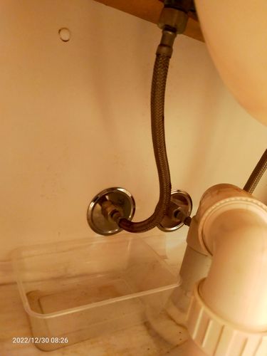

Thanks @EricL . Can anyone advice me what tools I needed to unscrew the tap and the bottom piping? I just got the new basin from Bunnings. Just wanted to make sure I got all the necessary tools to change.
Re: Changing Bathroom ceramic basin
Hi @calccom21,
You'll typically need a tap spanner for the tap spindles and possibly a pipe wrench to remove the tap flanges if they're stuck. The pipe wrench can also be used to undo the bottom piping.

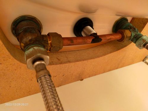

Thanks @MitchellMc .by the way I realised my bathroom doors not have shutting off the water valve. I'll need to go outside my main water switch to turn off if I need to do any work and means that all house will not have water. Did anyone know if there is a be temporary pipe cap that I can close of the pipe while I do my renovation so other areas of the house have water?
Hi @calccom21,
A 15mm threaded cap would suit those wall fittings. You'll also need some threaded tape to seal them.

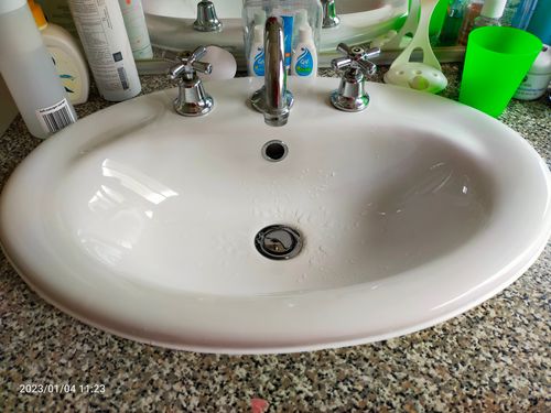

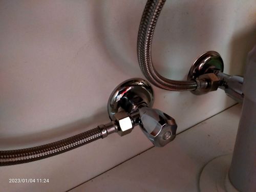

Hi All,
   Many thanks for the help. I got a very helpful plumber to get it done for me as I do not have proper equipment in sawing off the countertop. He also recommended me to put the valve on hot and cold water so I don't have to switch on/off the main switch
