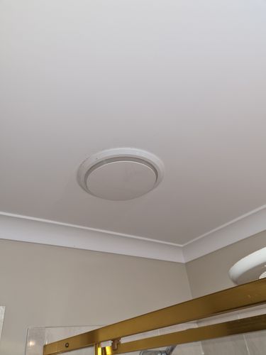

You need to measure your existing cut out hole and the cover plate diameter (one side to the other) write that down as you will need that.

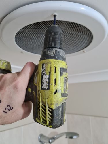

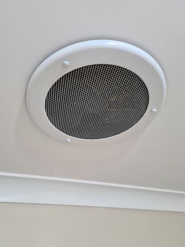

So you will need to climb up the ladder, the cover plate will either clip off, screw off or come off 2 spring clips but before you remove don't forget to measure it and record it.

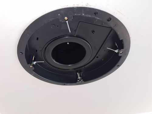

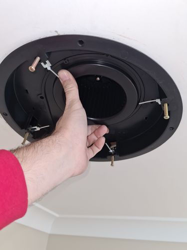

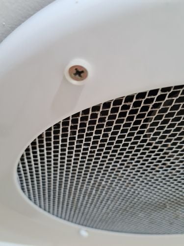

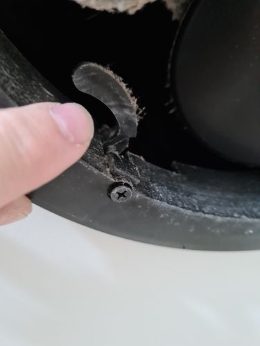

After the cover you will have 3 or 4 screws that will be holding tabs that either spin to hold or lift up then slot inwards that you may have to slide in with your finger as per below.

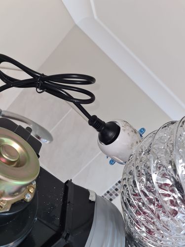

After undoing all of these the exhaust fan will drop from the ceiling so hold onto it, then gently pulling on the power cord the plug base should fall from the ceiling too. Unplug the lead and then place the fan on the floor allowing you to then measure the cut out properly.

You are going to want to look for the closest in cutout size and overall size, the overall must be bigger than your cutout otherwise you will not cover the existing hole. If you have a good match on cut out you can look at square if you existing is round but if like me there is very little forgiveness the chances it may not cover.

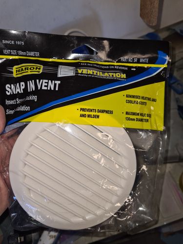

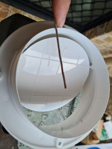

So you have found the suitable ducted exhaust fan based on your existing cutout and also room size (found on boxes), the next thing is check the distance of the included ducting you may need to purchase a longer duct for the rated size or a joiner and a extended duct. I also decided to grab a different vent as the ones that came with it were for vertical wall not horizontal eves as per below.

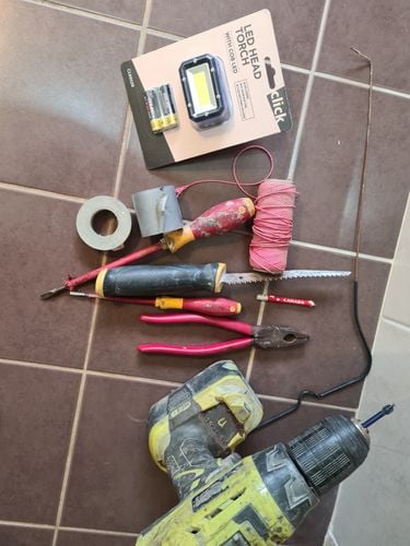

Whilst you are at Bunnings make sure you have the following tools.
A small blade screw driver
A small head hammer or pair or pliers
Some bricky line or string line
Gyprock saw (if you need to cut any out of ceiling)
Pencil
Duct tape
A torch of some kind
A wire coat hanger
A length of conduit 20mm or what ever length from exhaust to eves

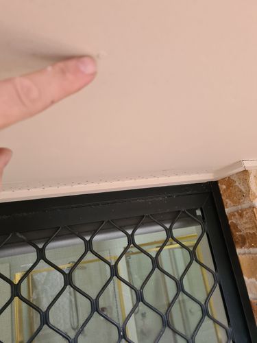

Next look at the outside vent grab hold of that and head outside with your set of steps, pencil, flat head screw driver, small hammer or pliers, tape measure and coat hanger. We are going to find the center of the timbers which can be identified by looking for the clouts running from the wall to the gutters, you can also push on the eves with your palm and check for movement, good movement and no sign of clouts your pretty safe.
Next we are going to measure centre between wall and gutter and mark. Next with the small flat head and small hammer bang a hole in the eves.

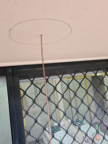

Next with the coat hanger we are going to measure it against the duct grill to half way and bend a right angle, then we will poke the coat hanger up into the hole and spin it around and push it up feeling for any obstructions. If all clear we are good to mark out the circle, if we have an obstruction one side we just need to shift over.

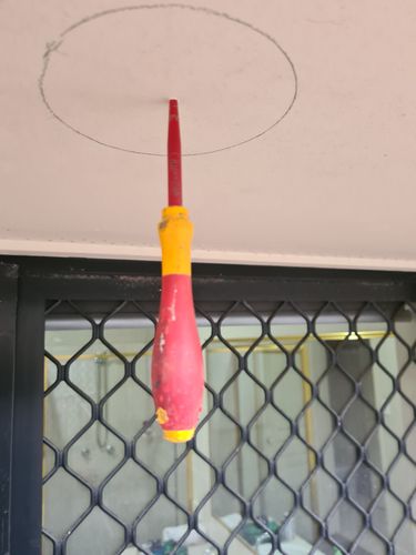

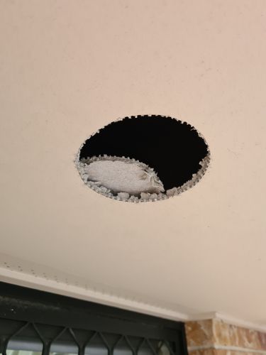

So next place to grill with the circle over the hole and mark with a pencil

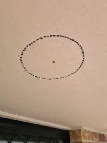

After this the fun part and trust me I've tried all the methods and they dont work so its down to burning arms. You work your way around the circle taping out the hole with your screw driver keeping the spacings tight once complete hit the centre and it will pop up.

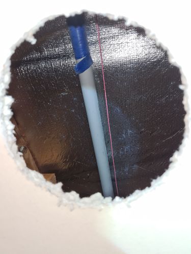

Next we will head back inside, you want to poke a hole in the start and end of the ducting one end cut a short bit of brickie line enough to tie off to something new the inside cut out.

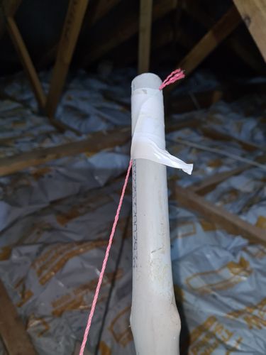

With the rest of brickie line tape it to the end of the conduit but leave it on the roll.

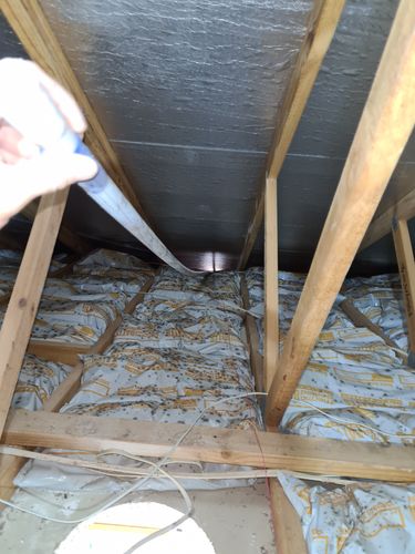

Next head up on the ceiling unless you can squeeze up enough in the exhaust fan hole we are going to push the conduit and brickie line to the hole in the eves.
Once there head to the eves and grab the conduit and the line and tie it off to something.

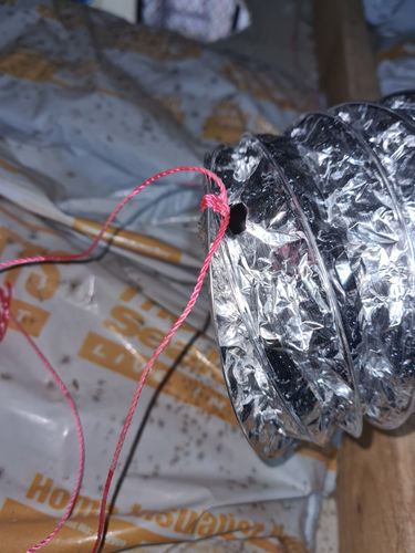

Next we want to take the duct up and tie one end off to stay at the inside hole and the other end we are going ro cut the brickie line off the roll and tie it to the other end of the duct.
Then head back outside and pull the line pulling the duct to the hole, take it slowly once near the hole put your hand up and grab it and pull it through.
I have just saved you squeezing into the corners of the roof cavity. The other option is to kick tiles but if like me you have solar panels it's not an option.

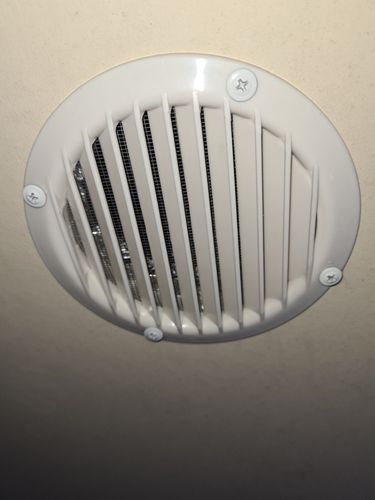

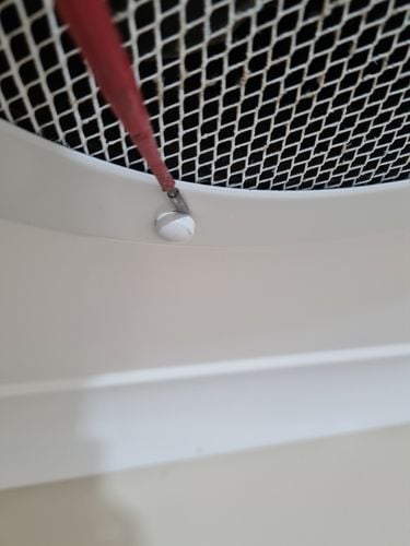

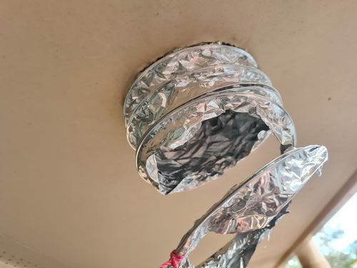

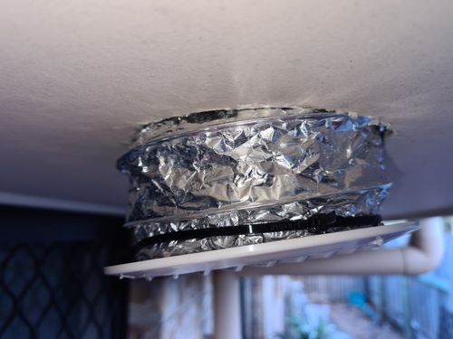

Next I trimmed off the duct and put the eve grill on and fixed on with cable ties then fixed up with button screws.

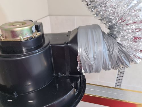

It's time to head inside and finish this off, now it's a matter of cutting brickie line off the duct trimming up and then grabbing the new ducted exhaust fan. Slot the duct over the outlet of the fan and fix with the provided cable ties or clamps and finish off with some duct tape for extra seal.
