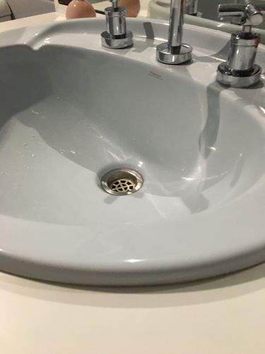

On a budget and was wondering if you can paint bathroom sink? My sink is in good condition but would like it to be white. If yes, what do I need to paint it with? Thank you

Can I please clarify if it is the basin sink you wish to paint or the vanity? I only ask as the sink appears to be a shade of white and the vanity a cream colour, this could just be the way the colours appear on my screen though.
For the basin sink, I would recommend Rust-oleum Tub And Tile Refinishing Kit as it is a fast-drying durable coating that acts and looks like porcelain and ceramic.
For the vanity, I would advise using the Dulux renovation range of products for laminate benchtops as they are waterbased and easy to apply, durable and chip resistant and tintable to thousands of colours.
Here's a step-by-step D.I.Y guide on How to paint laminate and benchtops which you might find useful if you paint the vanity. I'll also include below an instructional video on applying the Tub and Tile paint.
