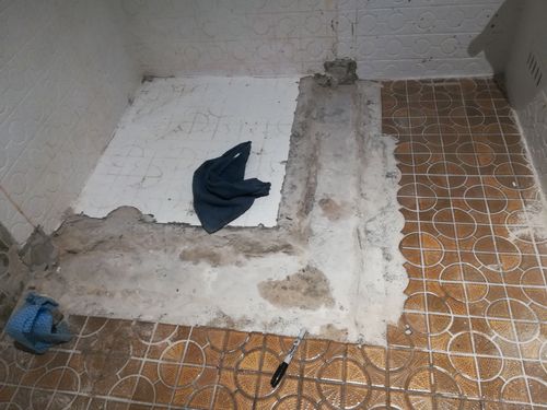

I have a old shower hob where the curbs are made of bricks.
the shower is too small, so i've decided to remove the curbs and make a curbless shower.
the shower floor already sloped, so I'm not gonna dig into concrete floor and build a sloped pan.
I'm just gonna remove the curbs and the floor tile, prime it, put waterproofing membrane and install new tiles.
i've figured all the parts out except that i have no idea how to remove the curb.
i've remove the tiling on the curb, but the curb looks to be made of bricks attached to concrete floor and glued together with mortar.
I've been working with chisel and hammer but removing the mortar was best i could do.
could you please suggest a method or a tool (non expensive preferred) I could use to remove the bricks and reach the concrete floor?
Thank you

I believe the bricks will be bedded on top of cement. You should be able to take a Craftright 1.35kg Club Hammer and knock them straight off. The rubber mallet is not very effective at this as it is absorbing most of your force. You need sharp impacts to the brick to fracture the cement bond with them, the steel club hammer is much more effective at this.
You'll most likely need a grinder for this job as it will come in handy for smoothing off any bricks or tiles you can't fully remove. Depending on the number of tiles you need to remove an Ozito 900W SDS+ 3J Rotary Hammer Drill Kit would also be helpful.

I followed your advice and bought a rotary hammer drill. Once i emptied 1cm around the curbs down to the cement attachment under the bricks, slight hammering of the cement with the hammer drill knocked the brick off clean and easy.
Thank you very much for your help.
Could you please advice what product I can use to fill the cutout left by the curb and bring the surface back to level. It needs to bond with the cement around it and its around 5-6cm deep.

At this stage, it would be my advice to remove all the floor tiles. You'd then use Lanko 20kg 133 Pro Level Floor Leveller over the whole floor. You can have a professional waterproof the slab or install a shower base. If you decide to not use a pre-cast base then you'll need to remove wall tiles as the waterproofing has to be across the floor and up the wall. This needs to be a continuous layer and you are not able to simply water-proof the floor alone.
Your original idea of tiling over the existing tiles might not be possible now that you have effected the water-proofing layer.

I totally agree with you. I have removed the tiles on the rest of the floor but left the slab untouched. In the shower area i have removed the entire slab along with waterproofing membrane embedded in it down to the same level as where curb was removed. I'm planning to remove one row of the wall tiles without breaking them, apply waterproofing using Crommelin Waterproofing kit on the entire bathroom floor plus the first row of wall around the shower area. Since the original waterproofing up the shower wall is intact, as long as I overlap the new waterproofing with the old one on the wall, this should be more than sufficient to create a continuous seal.
Then I pour in the levelling mix and create the sloped curbless pan towards the drain.
After that I'm planning on doing another layer of waterproofing on top of the pan and the rest of the floor just for extra measure. then i put thinset on floor and first row of the wall and tile it.
