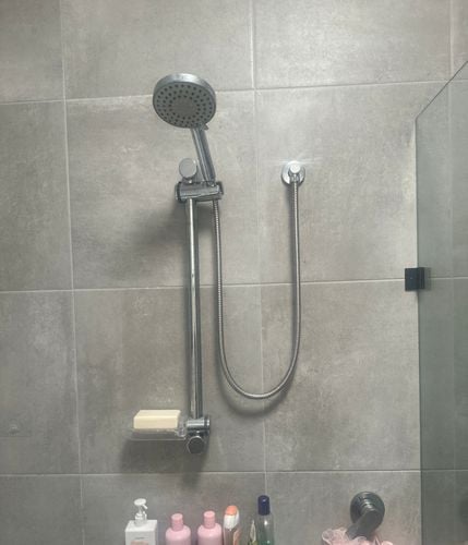

Hi everyone,
I’m looking to convert a hand-held shower into an overhead (fixed) shower, but the existing water outlet is not in the center, and I’d like to avoid breaking tiles.
Is there any assembly / extension / adjustable shower arm available that allows this kind of conversion without drilling or tile work?

As a possible solution, I propose thinking about installing a Brasshards 15mm Galvanised Female And Female Elbow and a Brasshards 15 x 100mm Galvanised Pipe along with a Brasshards 15mm Galvanised Male And Female Elbow. I suggest assembling the three pieces together making sure that the elbows are facing in the correct direction. Make sure to use FIX-A-TAP 12mm x 8m Blue PTFE Thread Seal Tape on all threaded surfaces to prevent leaks.
When the extension is assembled slowly screw it to the threaded brass nipple on the wall. It's important that the extension finish on the lefthand side close to being horizontal and must be firm but not overly tight. Once the extension is in place you can then install either the Mondella Brushed Nickel Overture Shower Arm and Rose or the Estilo Chrome 3 Function 1/2 Twin Rail Shower Set. It is not a perfect solution, but it will allow you to position the shower head closer to the center.
