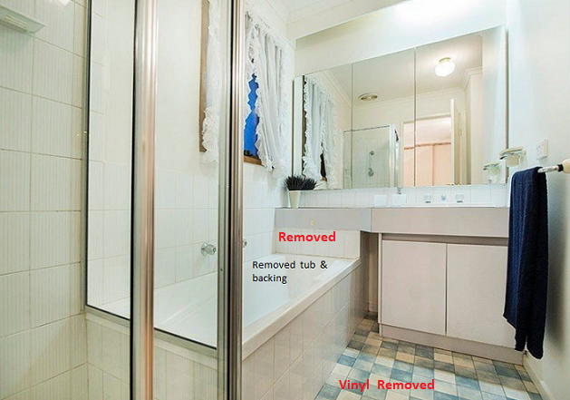

Since I started recently, everyday after work & on weekends I roll up my sleeves, and have managed to remove the bathtub, removed the frame holding the tub, removed pipes without damage and have achieved the space I desire in my bathroom (successfully).
Now I just have to get a new shower, redo my floor and add a bench - - Woohooo!!😃🙌 - Its been fun!! See pic of what my bathroom looked like.

I'll start with saying an extremely gigantic Thank you to you, to Mitchel and the great Eric🤗 - I'm looking forward to sharing some pics with thew team - With the prompt advice given by the team, on the "how to .....", I managed to;-
Remove tiles from my bath tub,
Remove many other things surrounding tub,
Lift tub from setting (it was acrylic) - I gutted the bathroom exactly hpw I envisioned,
Removed the old vinyl flooring,
Even removed the entire shower screen, left the base, now I'm ready to have a new shower-screen put in place.
I have definitely taken many photos and short-videos - Which I will make into a home-movie, to show my kids😊
When I share my pics, please point out any mistakes I've made, so as I correct it.
