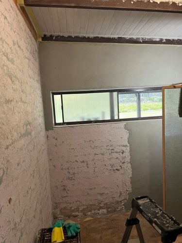

Step 1
The strip and surface preparation began.
Step 2
Walls were buffed to remove the introduced plaster texture and walls rendered to level out and bring in some more natural texture to the room.

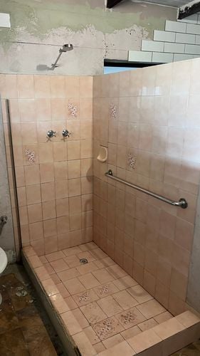

Step 3
The old pink shower was stripped and ripped. Tiling began on walls that remained.

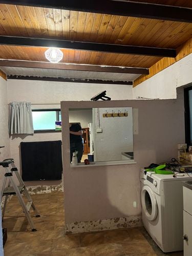

Step 4
The shower wall was trimmed back to a more standard size, extended wall to the roof on the right side and a small nib wall built on the left to suit the new shower screen size.

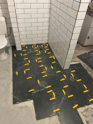

Step 6

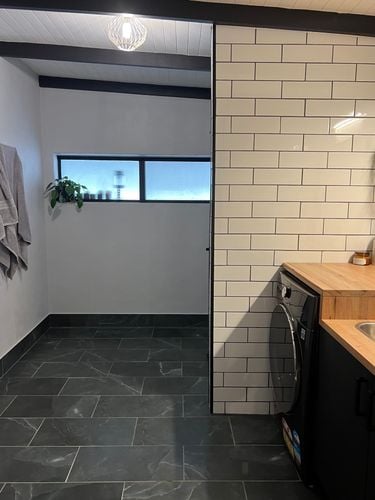

Floor tiling commenced.

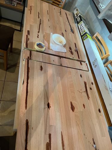

Step 7

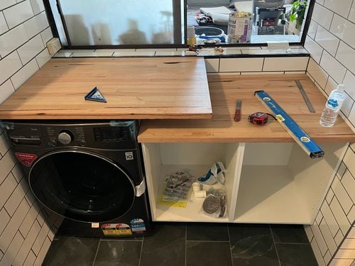

Hardwood resined prepared for the sink and washing machine bench.
Step 8
Bench and cabinets cut to suit.

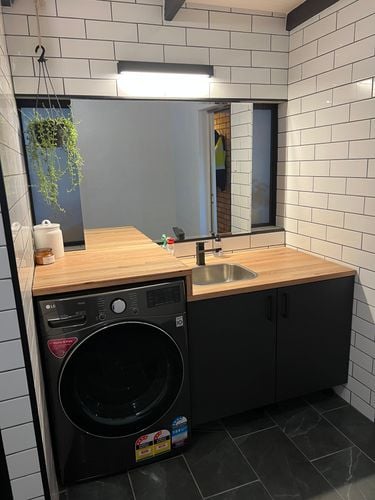

Final cabinetry, painting, washing machine installation and mirror fitting.

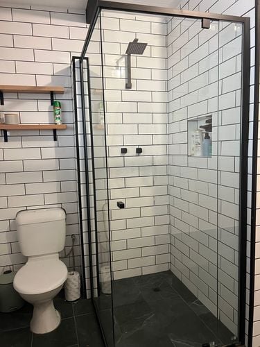

Step 10
Shower screen install (definitely a two person job), tap and handles fitted, trim and shelves installed.
