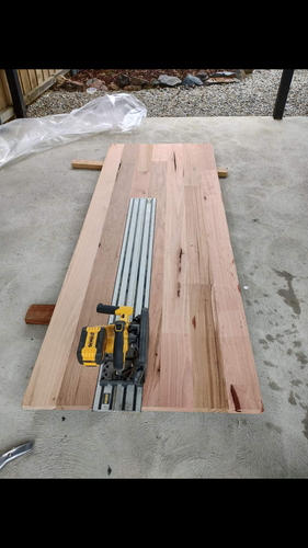

1. Rip the 900mm panel down the centre to give approx. 2x445mm pieces.

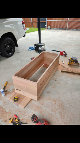

3. Glue and screw all the pieces together to create a box. We used nails and glue at the top to avoid seeing the screw holes.

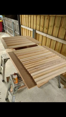

6. Measure and cut your door backings to suit the cabinet, allowing enough clearance for the hinges.
Step 7
7. Glue and trim the Cirque pieces onto the MDF backings and install doors to cabinet, adjust/trim as necessary.
Step 8
8. Sand and seal the doors, install some handles and it's ready to hang on the wall!
