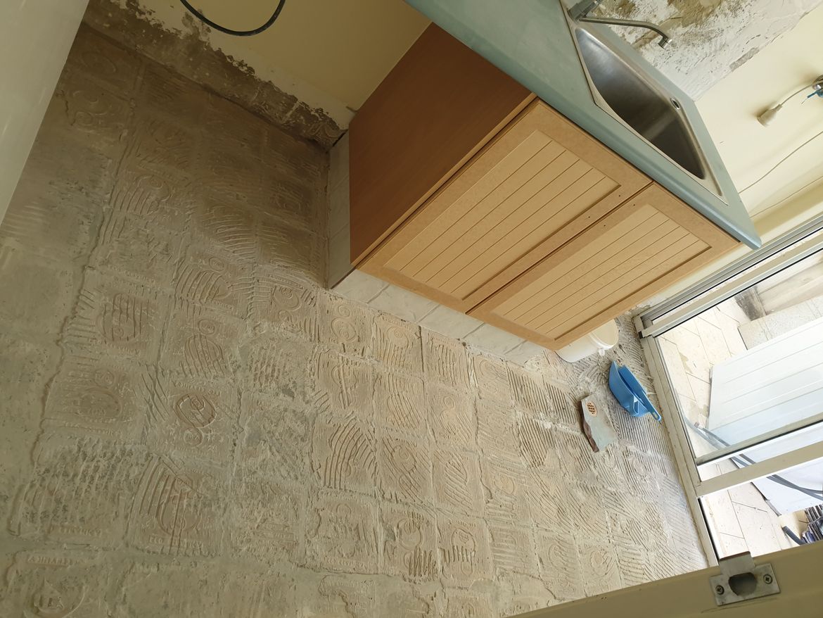

I know what I want the finished product to look like, and I have made steady progress up to now. All wall tiles & floor tiles have been removed. I'm working on removing the tile adhesive from the floors to get it smooth for the waterproofing and new tiles - if you look closely on the left, you can see the bit that I have been working on smoothing (I know I will have heaps more questions about this stage and prepping for tiling).

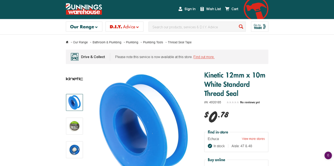

3. Use the thread tape on the threaded fittings attached to the copper pipe ( maybe 3 or 4 rounds, no more than that )

progress shot
Moving on the the walls and thinking about prepping the floors for tiling - I have heard about waterproofing and will look into and read up on that tomorrow - but is there anything specific that I need to look out for or be careful of?

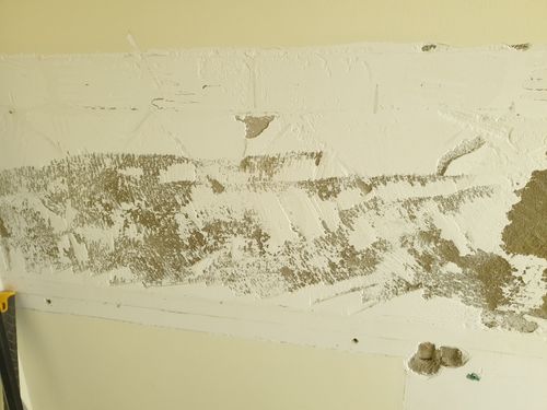

We are also wondering about the walls, should we plaster it back up where it has been chipped? then prime? Again, any advice and guidance from this awesome community will be greatly appreciated.

Hi @ChristineM.
Are you planning on tiling over the damaged portion of the wall? If so would you like to share an image which has more detail of the chipping? If it is not too significant you might be able to just tile straight over it without having to go about patching it first.

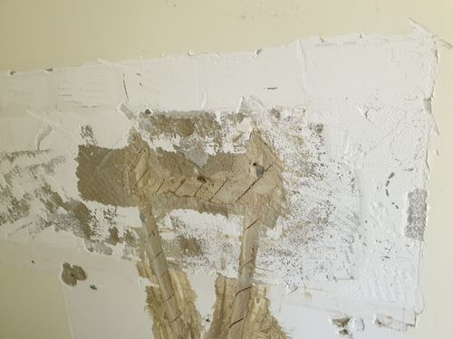

Hi @MitchellMc Yes, we will tile over where thw original splashback tiles were. Here is a more detailed photo:

I hope these photos give a bit more detail
