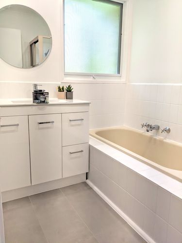

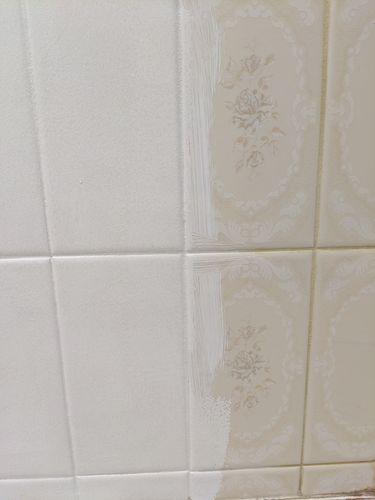

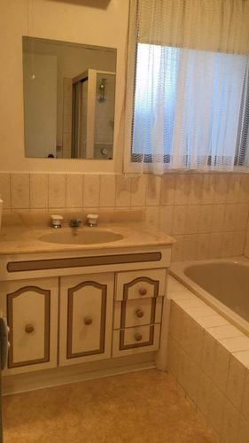

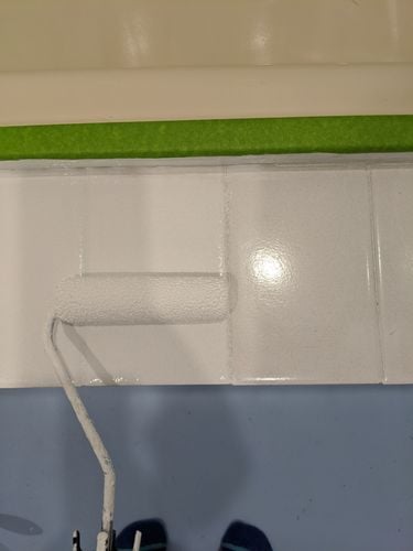

We used the Dulux Renovation Range tile paint to update and refresh our bathroom. First we removed all of the silicone from the tiles using silicone softener and a Stanley knife. Before priming the tiles we made sure all the tiles were clean using Selley's sugar soap. We did 3 coats of the renovation range paint and then sealed with the recommended top coat and silicone. The old vanity was removed and replaced with a fresh white modern unit. We replaced the dated vinyl flooring with modern tiles and upgraded the tapware.
A year later our tiles still look amazing and all done for under $1000.00
