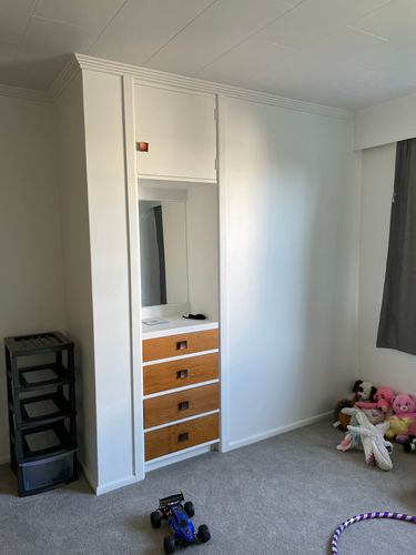

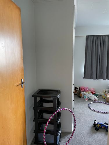

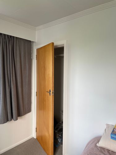

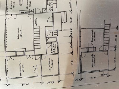

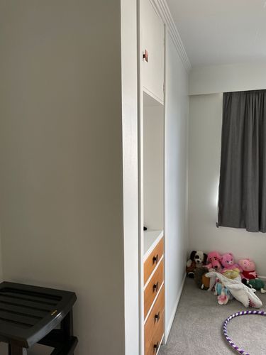

So grateful to have such a positive response from you. here are some pics...
Hello @JP9
The minimum allowable size for a toilet is usually 1 meter wide by 2 meters in length. A wardrobe is not that big. Walls may need to be moved and plumbing connections will need to be considered in the initial stage of planning. Should these issues be addressed I see no reason why you can't have an en-suite in that particular area.
Red
Thanks. Yes, I will have to move the wall from the one bedroom.
Hi @JP9,
It's great to see @redracer01 has been able to assist. Was this en suite to be accessed by both rooms or just one, if it was just one which one? What's the current measurement of the closet? If you were to move the wall out to inline with the window in bedroom 2, then you might have enough space. If it came down to centimetres, you might like to consider a toilet/sink combo.
Hi M
It will eat into the downstairs bedroom, the one below the master bedroom upstairs. this bulge of the room cupboard and the dressing thing in the adjacent room is about 2m. Can be seen in the picture.
