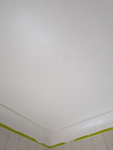

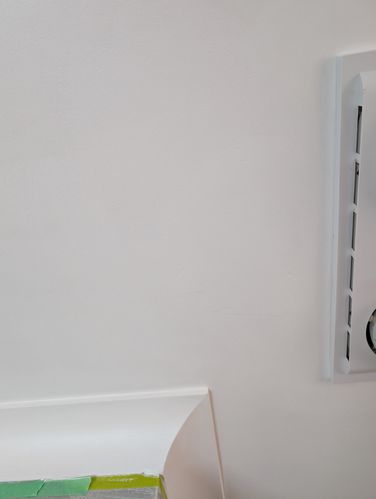

So I've put my first coat of Aquablock on my bathroom ceiling after scraping off some flaking paint and patching some holes with plaster. I'm about to put a second coat on and was wondering if there is any real reason to put a finishing coat of ceiling white over the top? The Aquablock itself is a nice white colour.

I've just applied the second coat and it is looking even better than after the first coat. It does come up rather shiny so I suppose a flat ceiling white will take the "shine" off a bit. Did you put one or two coats of top coat on after the Aquablock? I'm wondering if I can get away with just one. 4 coats of paint just on the ceiling feels like overkill.
