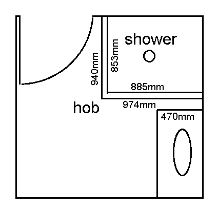

I'm looking for a corner entry sliding shower screen and noticed Bunnings has one 1000 x 1000mm. https://www.bunnings.com.au/rick-mclean-s-bathware-silver-euro-corner-entry-shower-screen-1000x1000_...
Just wondering if the shower fits the shower base. Or, I should look for 900 x 900 instead.
My measurements is:

Having a look at the Euro Corner Entry Installation Instructions, there are 900x900mm and 1000x1000mm versions.
The 900x900mm version will adjust between 850-870mm on both the front and the return.
The 1000x1000mm version will adjust between 950-970mm on both the front and the return.
Unfortunately, as your shower base is not a square and your base is frustratingly between sizes, I don't think either of these options will work for you.
Your options with the current layout of the room are either replacing the shower base to fit these measurements or contacting a glazier for their assistance in installing a custom shower screen.
This Estilo 900mm x 900mm 4 Lip Centre Rear Outlet Shower Base would work if you wanted to replace your current one.
