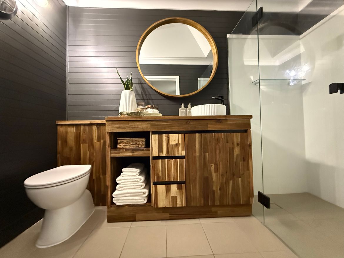

We have small ensuite that was very dated however had some nice neutral tiles and usable pieces so we decided to recycle as much as we could and renovate within those goals.
Acacia benchtops
Mondela taps
Paint, primer
Silicon
Spray paint
Toilet seat
Basin
Drill
Jigsaw
Nailgun
Circular saw
Sanders
Impact drill
levels
measuring tape
stud finders
Strip the old cabinet doors and all shelves
Patch holes in paneling
Paint paneling
Cut cabinet doors and benchtops out of Acacia boards
Connect new basin and taps
replace shower taps
replace toilet seat.
hang mirror
decorate
Hello @CoVerm
Welcome to the Bunnings Workshop community. It's sensational to have you join us, and thanks for sharing your wonderful ensuite make over.
This revamped ensuite is a beautiful example of how thoughtful updates and smart recycling can completely transform a space without needing to start from scratch. The use of natural wood for the vanity adds warmth and richness that contrasts perfectly with the dark vertical panelling, giving it a modern yet grounded feel. The round mirror softens the space and complements the curved basin and sleek black tapware, while the neutral tiles you chose to retain now act as a calm, timeless foundation. It feels fresh, elegant, and purposeful, like every piece was chosen with intention, and the overall result is effortlessly cohesive.

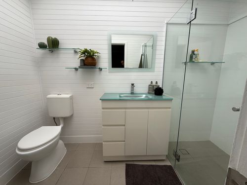

This was our before image. Re-cycled and re-used most of the components!
Hi @CoVerm,
Did you hide the toilet's cistern inside that custom cabinet?
If so, that is a really nice finish, which really shows how well thought out your project was.
Thank you for sharing the before image.
Yes we did as we wanted to keep the tiles and breaking out the old toilet would mean we have to redo the tiles. We just replaced the seat with new soft close.
