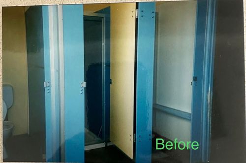

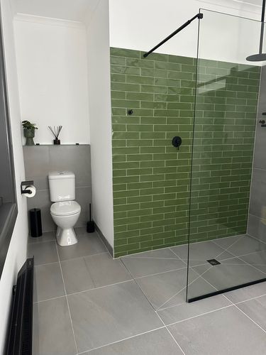

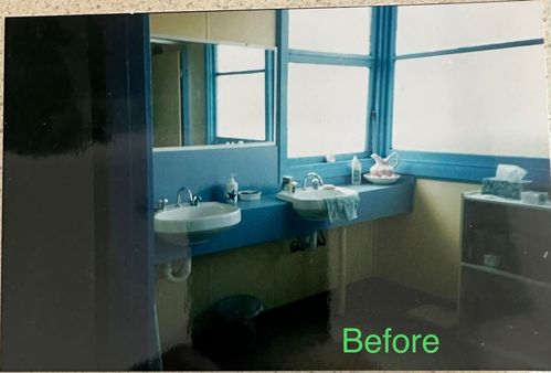

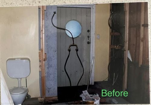

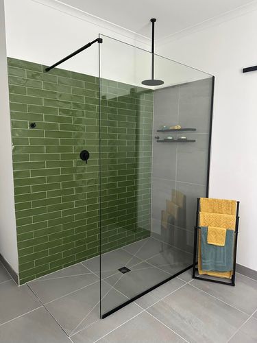

Finally we have completed our ensuite after being a storage room for 15 years, once we started it took around 3 months to complete as it was done over weekends.
We had to put a new floor in as it was rotted in places, then a new window, new plaster on the walls/ceiling, installed 4 way heat/fan light in ceiling, tiled the flooring, Waterproofed all the plaster, undercoated the walls/ceiling then 2 coats paint, installed the basin, toilet and walk-in shower base, then tiled the wet areas, installed all the fittings for basin & shower (taps). Our son made the barn door out of left over vinyl floor planks
