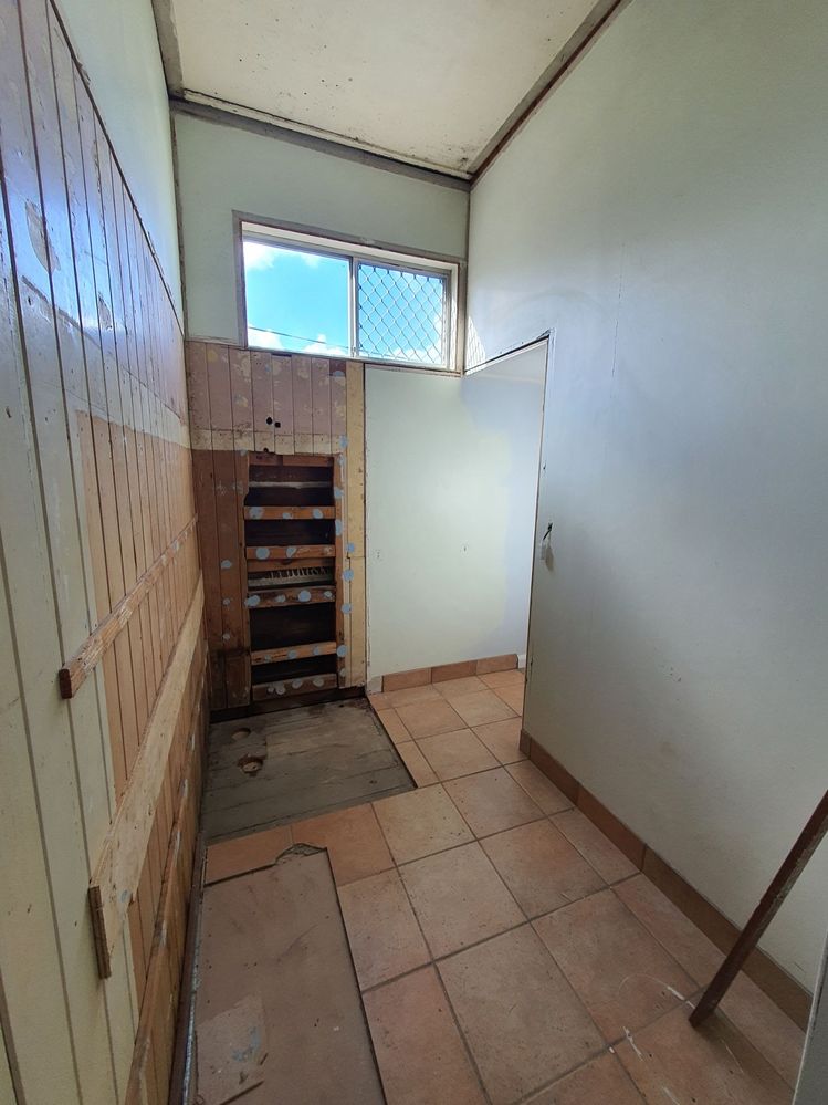

Fittings & wall tiling removed, old doorway discovered.
Fittings & wall tiles removed.

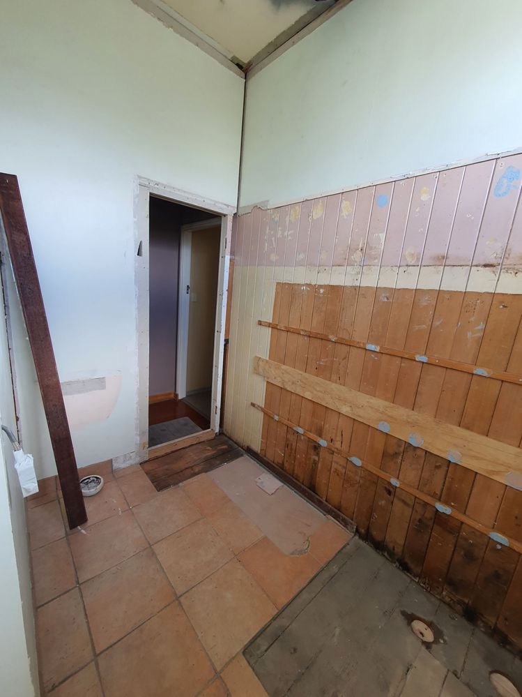

Wall lining and underlying VJ's stripped. Some shonky work exposed.
Fabulous old 1932 fretwork revealed.

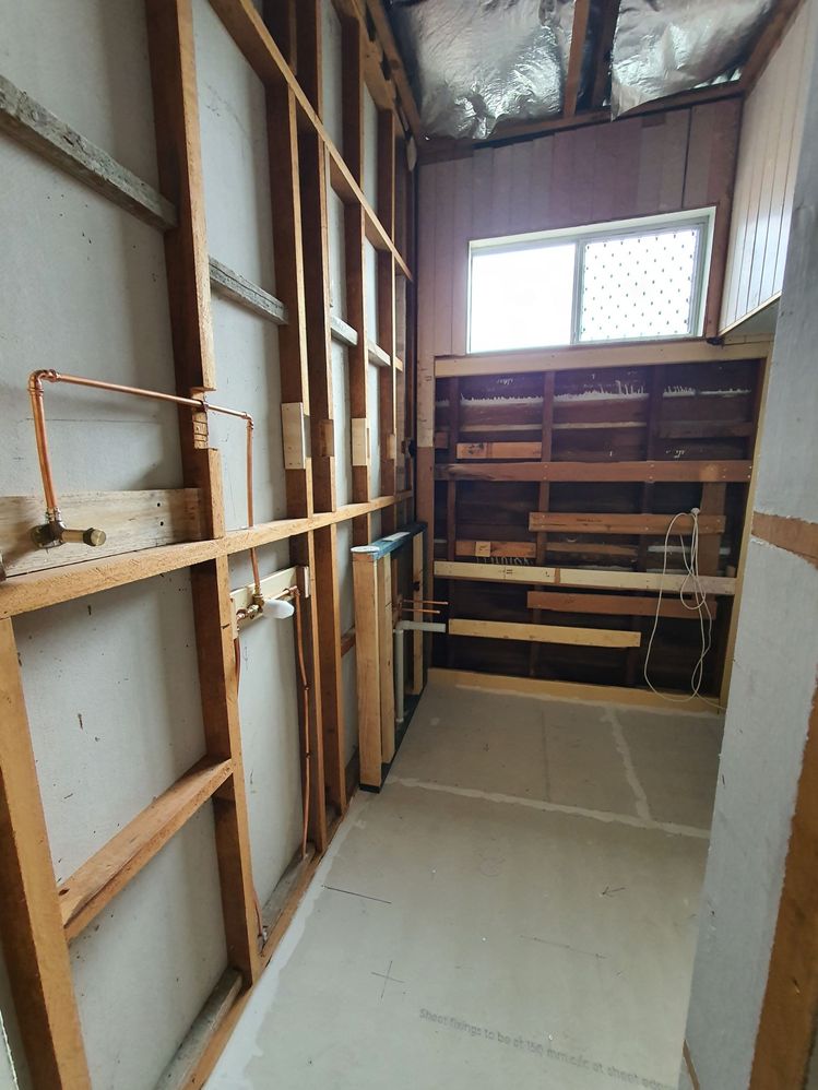

Straightening up old studwork and putting in bracing for wall fixtures.
Plinth for wall hung vanity bench.

Plumbing and electrical work looked like it was a DIY job from the 60's, shockingly bad. I redesigned the plumbing into different pathways to save headroom below and look much neater as well as adding in the dry floor waste. Electrical was much easier to redo, just cabling and tidying up.
The walls weren't very plumb and once I'd stripped the sheeting and then cut out the pine VJ's the cause was apparent ... unlike modern construction, the studs and noggings were reversed so the wall had little vertical rigidity. Not to mention that somewhere in its past huge rebates were chiseled out of the vertical noggings which I ended up fixing studs over. The rigidity and plumbness to about 5mm was resolved to all walls and the tiler's joy!
