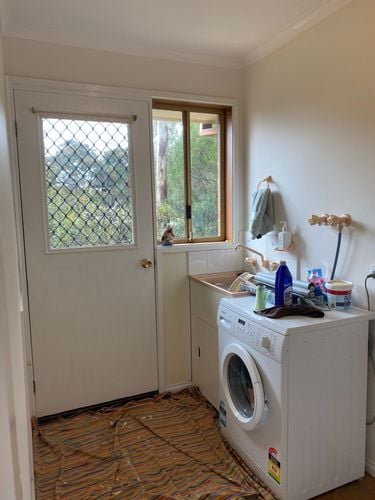

I am now a bit confused as to how to remove the old laundry trough cabinet and plumbing and then hide the washing machine drain hose in the new cabinetry.

I’ve uploaded my current laundry and my ideas for new laundry for your info (basically just flip this one).

Will you be employing the services of a plumber to move the tap wall outlets? If so, they will locate new connection points which are concealed beneath the benchtop and inside the cabinetry for you. Those connection points will have hoses that run directly to your new tap set and washing machine inlet. The washing machine drainage hose can be concealed in the vacant area behind the cabinets kick panels and run to the sink waste.
To remove the old laundry trough cabinet you would disconnect the drainage pipe from the waste plug via the large nut in the cabinet. In many cases, this is the only physical item holding a sink cabinet where it is. You might find that there is silicone caulking run around the top of the sink insert.  The cabinet could be attached with screws or bolts to the wall or floor. Once you remove the sink insert the fixing method should become evident.
