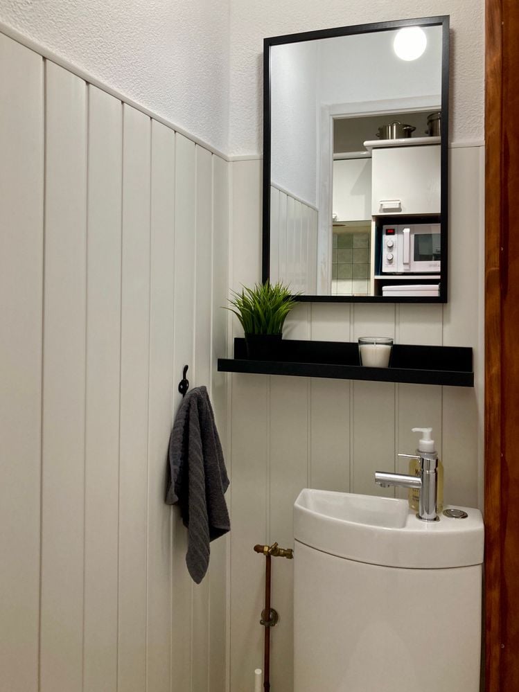

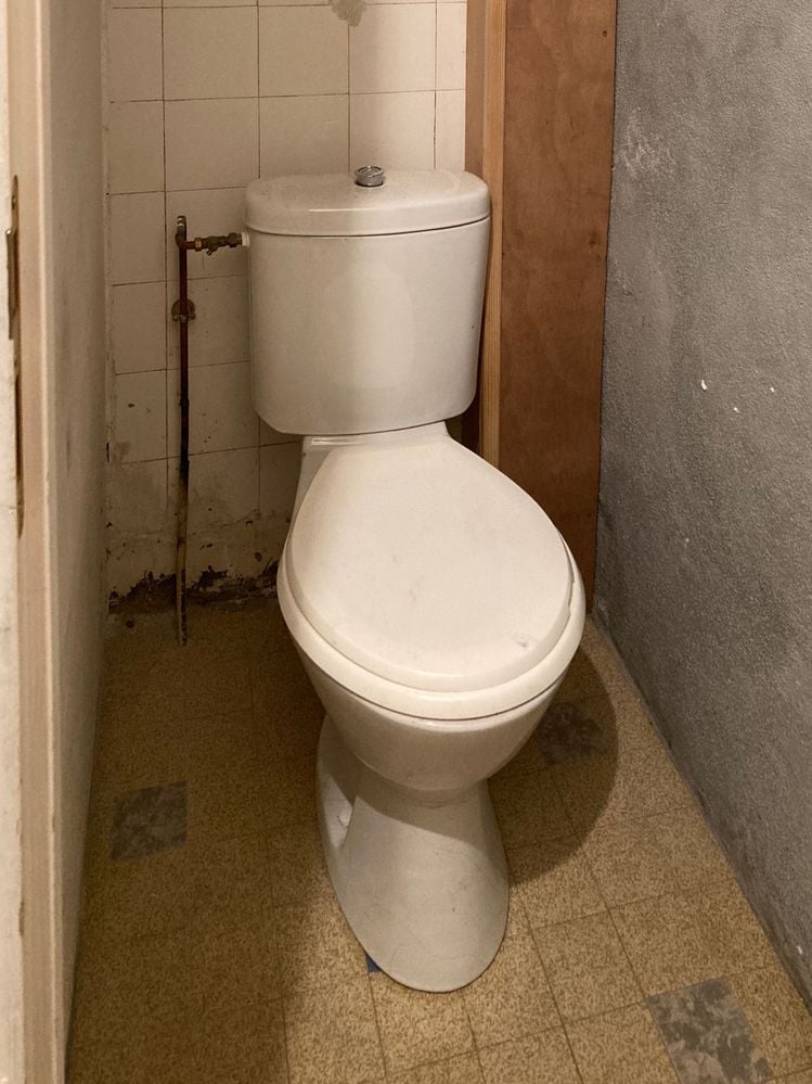

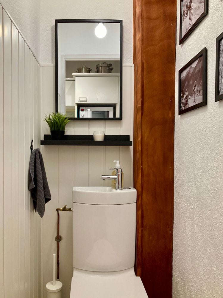

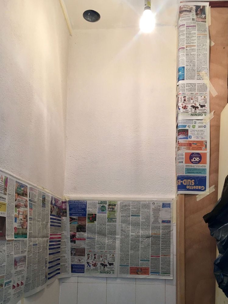

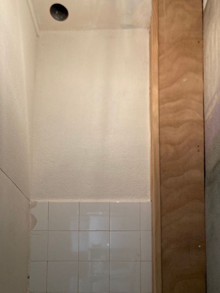

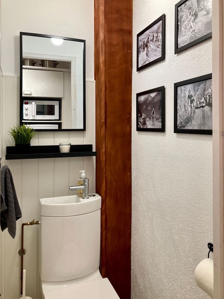

The guest toilet in our recently bought holiday home desperately needed some attention and working in a space with a footprint of less than 1sqm was the first challenge!

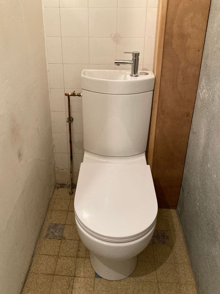

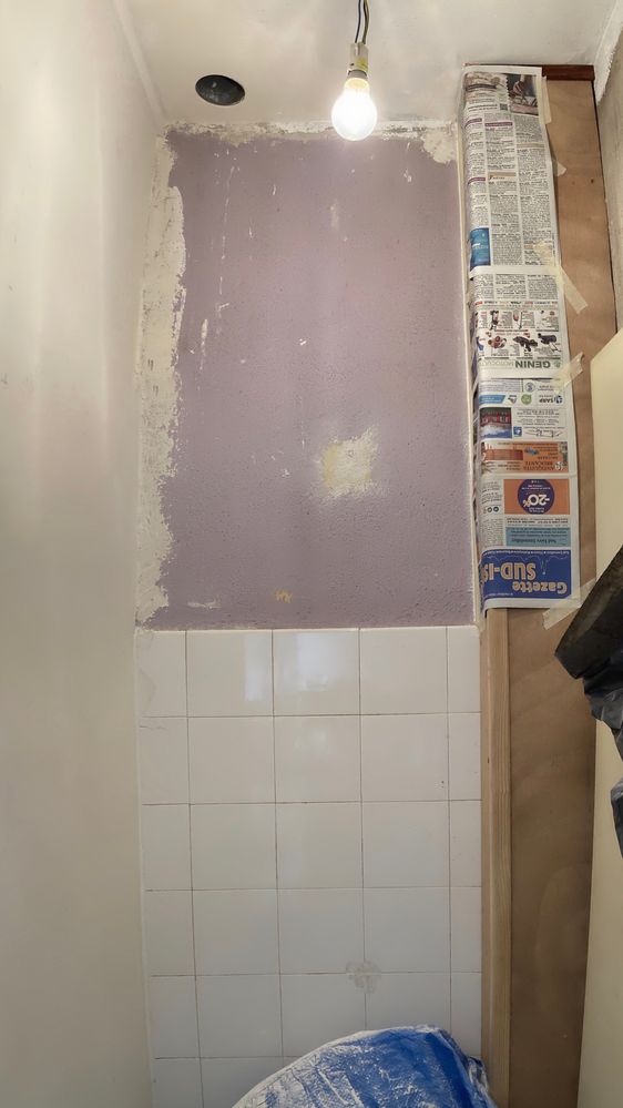

After swapping the old ‘standard’ toilet suite with one that has a hand wash basin (similar to the one at Bunnings: Caroma WELS, I/N: 4820814) I first applied some thin plaster and used a textured paint roller on the upper part of the walls to achieve a stippled look and cover up the previous, uneven filler patches.
This was followed by some bright white paint, rich wood stain and wall panelling (similar to the one at Bunnings: Easycraft Lining Panel, I/N: 0330364) for a Hampton-style wainscoting effect.
The wife took over with the finishing touches and decorations, all from her favorite Swedish furniture and home accessories store, and the end result guarantees a much more pleasant ‘experience’.
