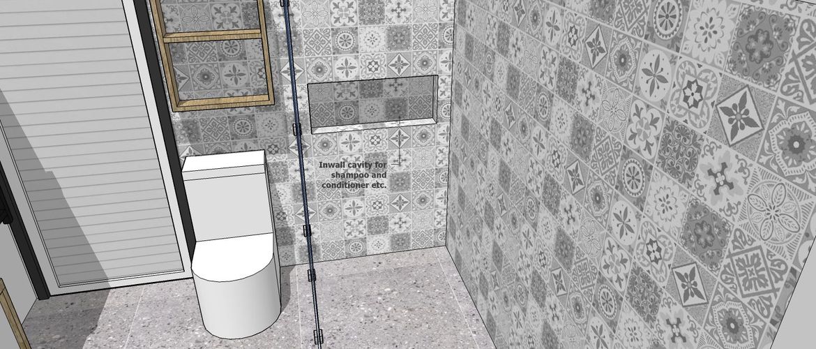

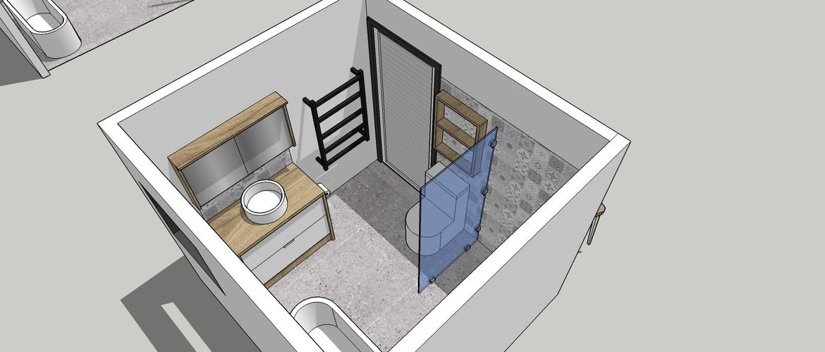

redracer01
Trusted Contributor
Re: HELP. need ideas for small bathroom reno!!
Hello @AmyCody

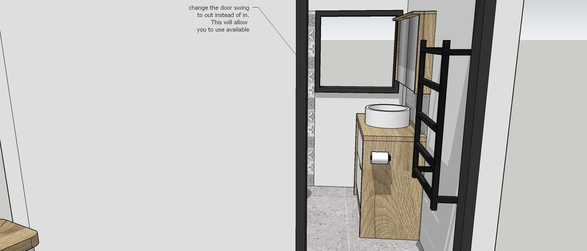

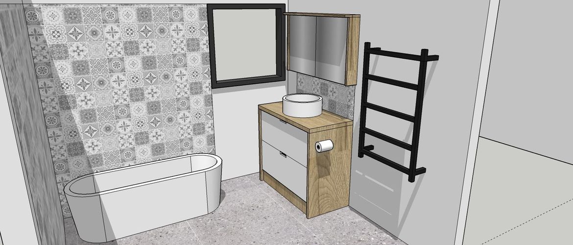

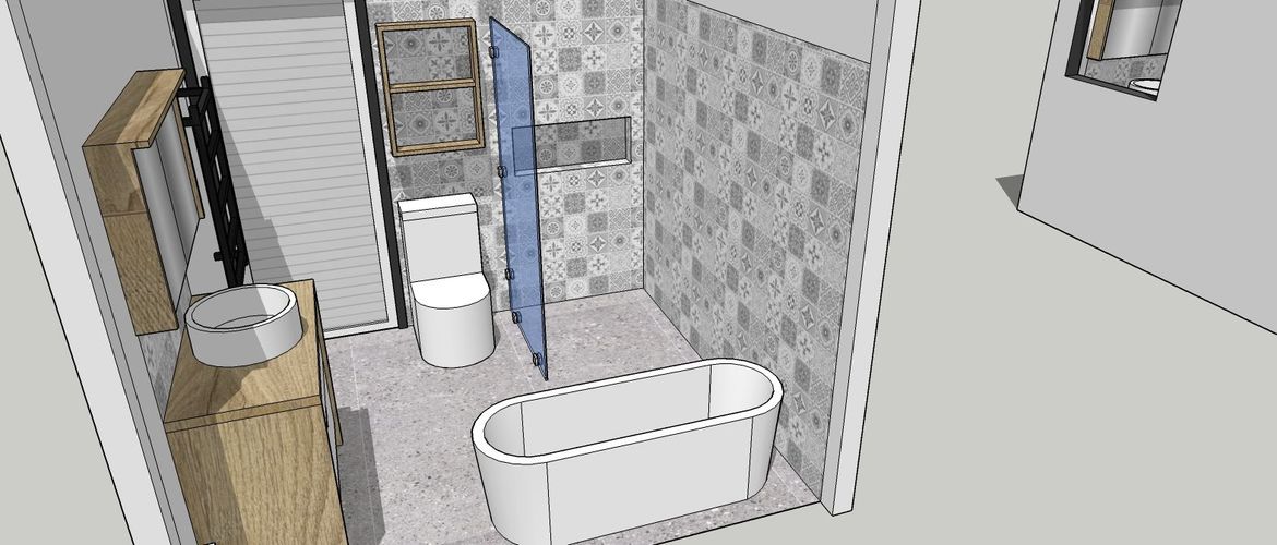

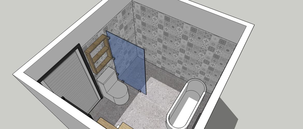

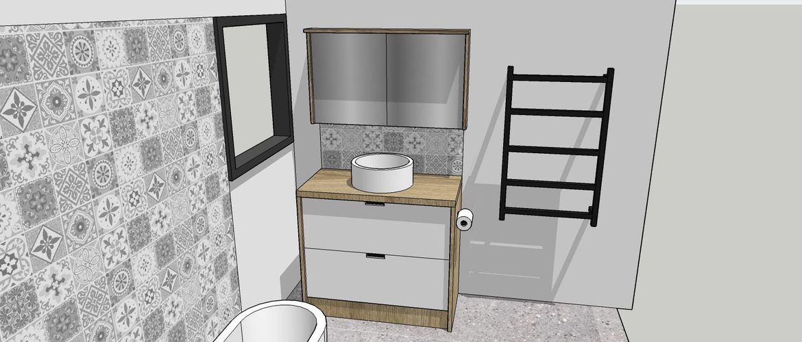

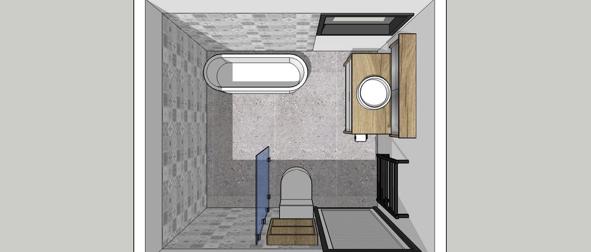

Here is a basic drawing of what it might look like once you've put all the necessary items in the renovated bathroom. I suggest to change the door swing from in to out to max out space use. Do not forget to put a heat / light / exhaust unit on the ceiling to remove excess moisture.
Cheers,
Red
amycody1.jpgamycody2.jpgamycody3.jpgamycody4.jpgamycody5.jpgamycody6.jpgamycody7.jpgamycody8.jpg
