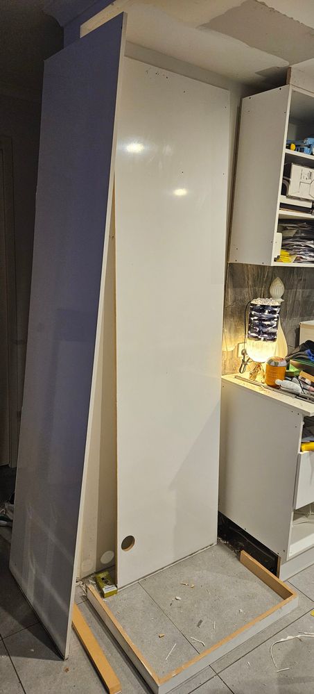

Tearing into another kitchen at my new Apartment
Redesign upgrade of existing kitchen which was more more suited to a 5 bedroom 2 storey home.

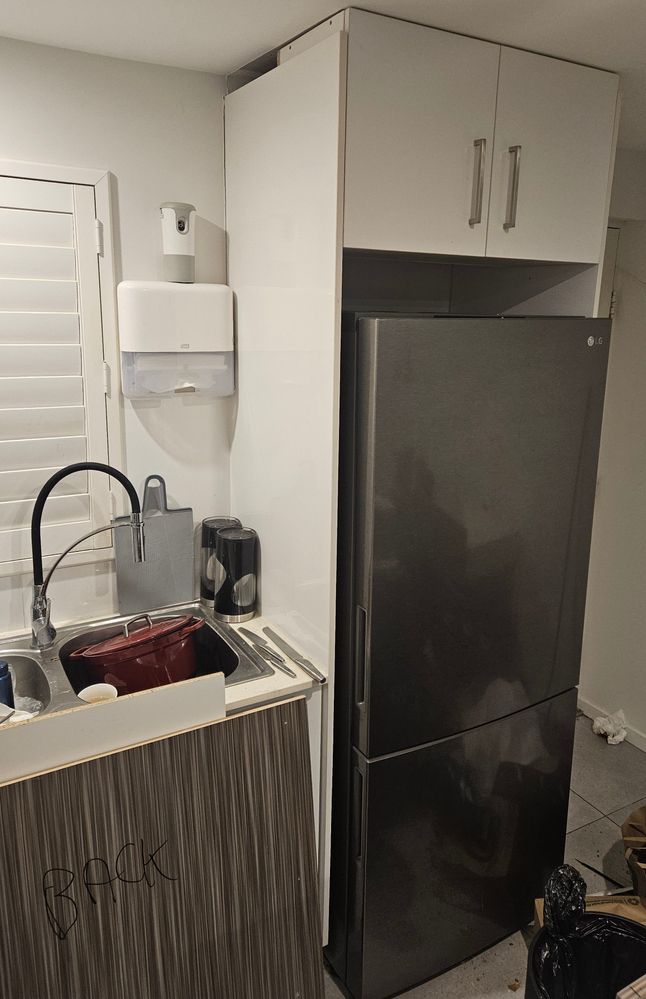

Relocated Fridge, Downsized pantry, rebuilt linen closet in old fridge location.

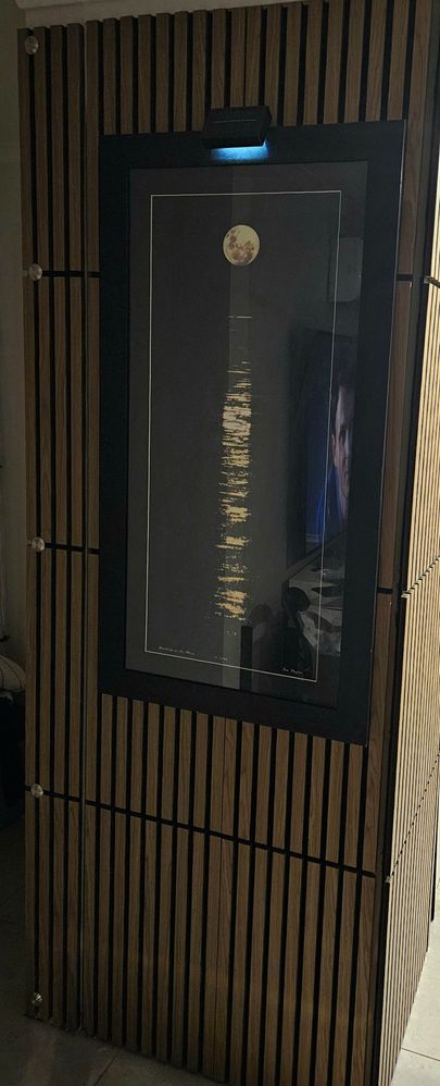

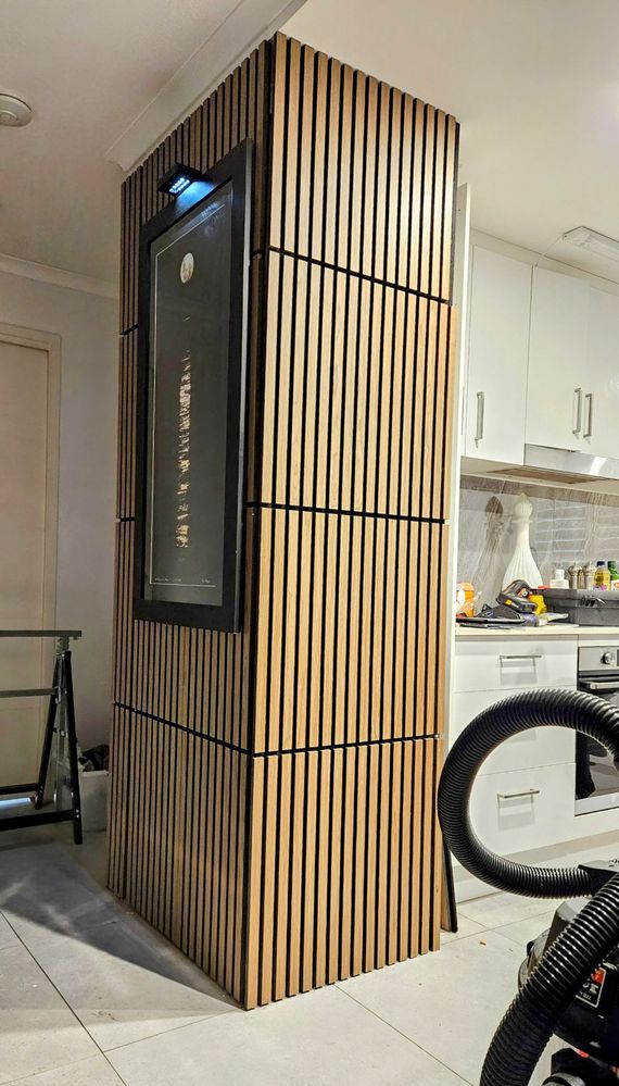

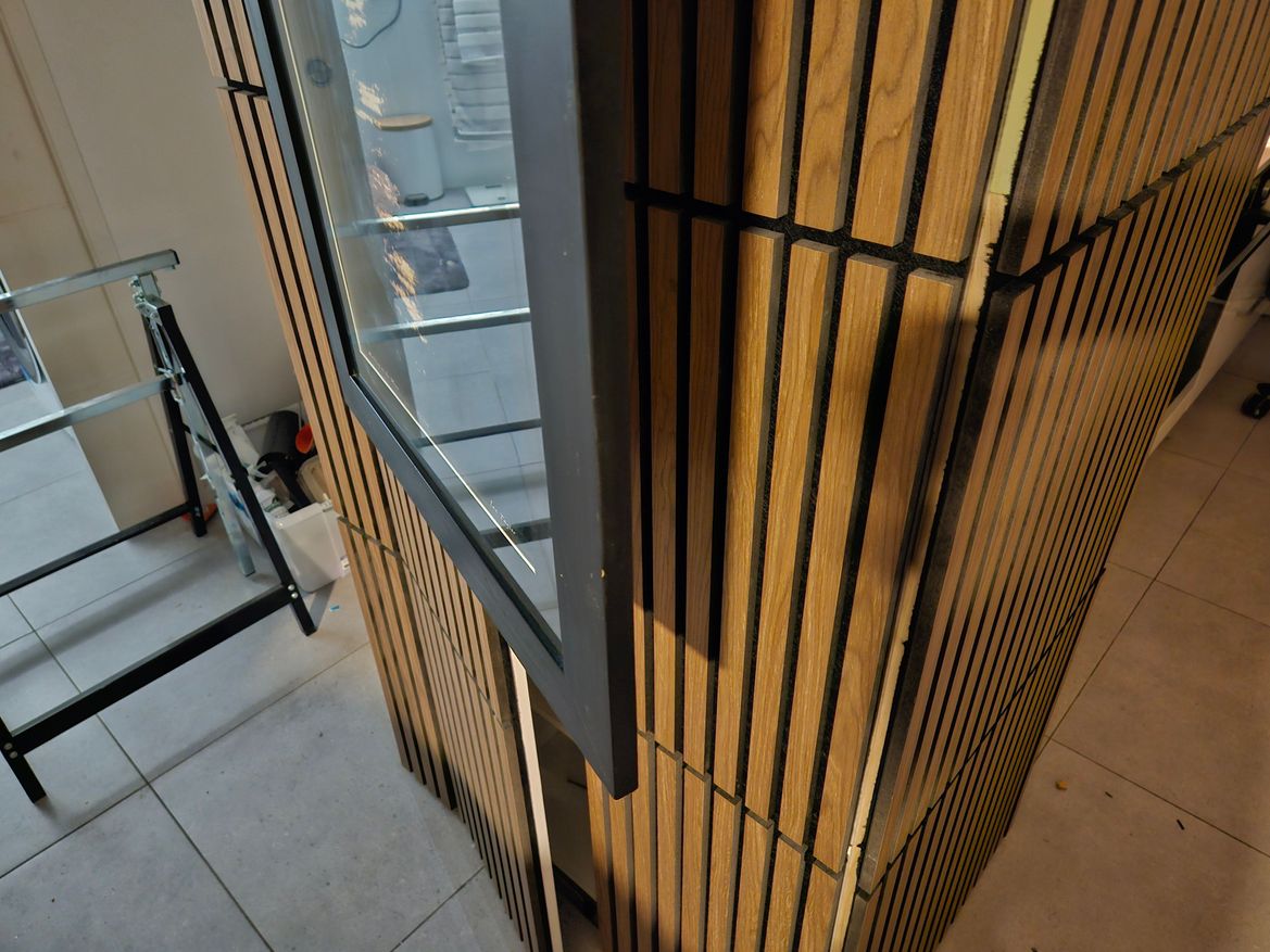

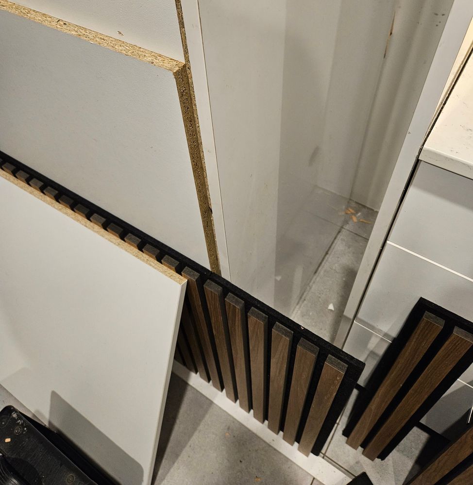

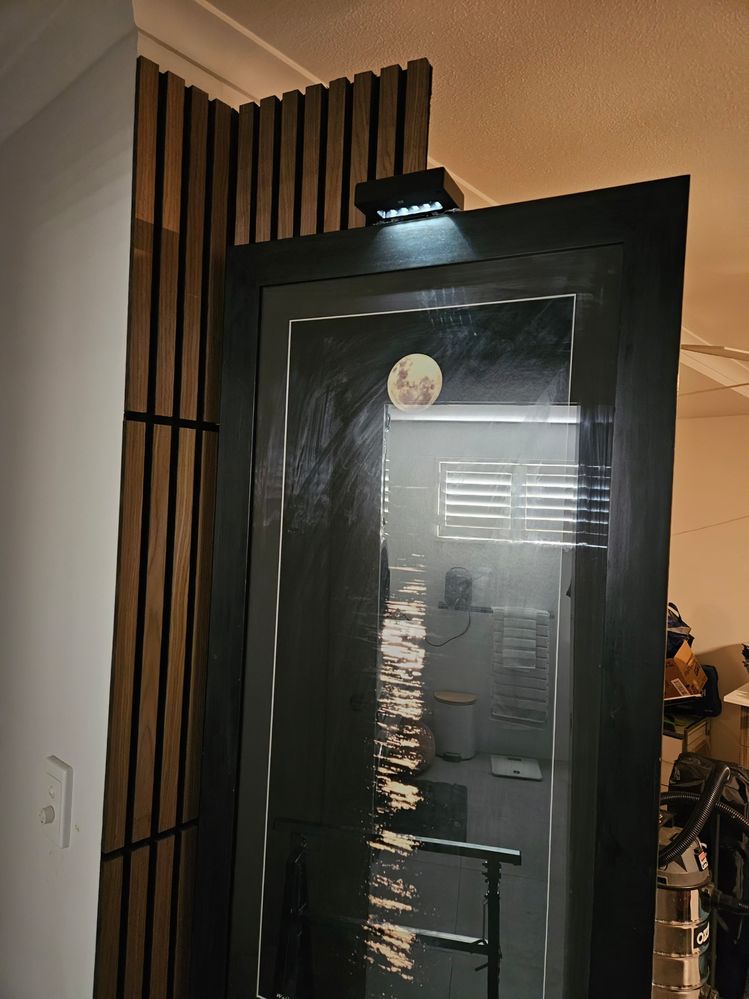

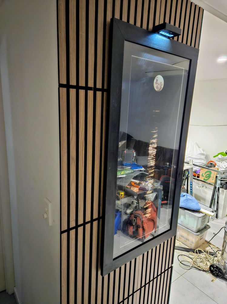

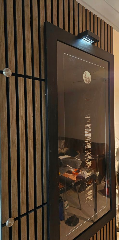

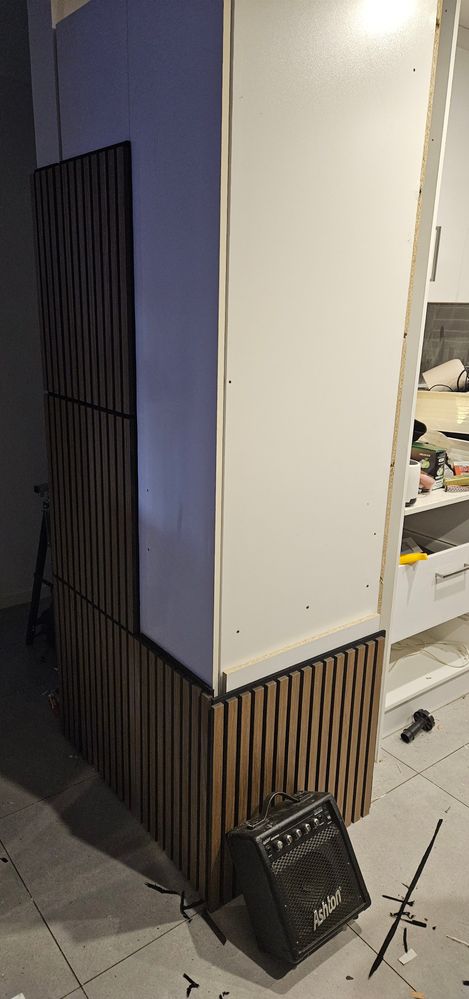

Final objective is too reduce footprint to allow a dining table and balance all areas in proportion to a 2 bedroom apartment Will include sliding mini cupboard to store ironing board and mop brooms etcHidden doorsThis product is fantastic and has more applications than just fixing flat to a wall, easy to install and visually stunningRemoval of fridge start of linen cupboard constructionNew fridge located into old pantry areaChecking gapsLaying out panels to ensure no waste and doors will open closeClose detail is sharp a reflection of this quality productOpen doors, picture swings with door to create the hidden effectAnother view of door open and then closed to conceal.
PS

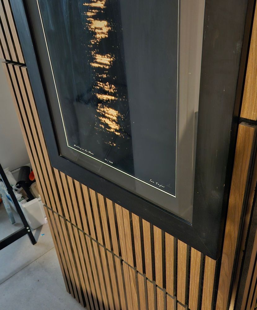

Final detailing such as gaps being blacked out, doors aligned, panels cleaned. Etc. But hopefully this will inspire you to try thus product out and be creative in its application, this is a striking product and too much could be over powering if used every where, I would advise to make it a feature not a wall to wall to wall covering

The timber panels/soundproffing panels caught my eye and then my eyes went wide as you described what you have done, love the way the picture frame half swings out 🙂 Brilliant idea.
I also like you have the sheets segmanted to give that stacked effect. What was your reasoning behind that instead of a long verticle design?
What a terrific project @Nishan1! I love the level of finish you've been able to achieve with these panels. I'd have never known there was a concealed cabinet behind them. Very ingenious.
Great work and many thanks for sharing.
Thank you Dave, appreciate the feedback, no reason other than choice, the full length would be alot easier to line up, but this was really easy as well.
I guess these panels are cnc cut to perfection so basically they lock together without any variation to the full length panels.
If was using it to line doors would probably go full.length.

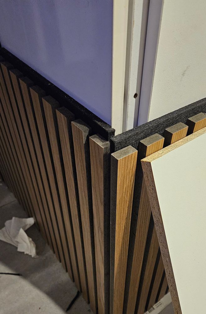

The panels are very easy to work with, it's just taking time to plan. When cutting panels use metal straight blade, use new blade frequently cut carefully, as your cut lines up with the whatever next, glue with hot glue gun, screw in between gaps and cover heads with felt strip cut off's, they become undetectable. Finally level every thing as you go, a couple of degrees adds up over 2-3 metres.
