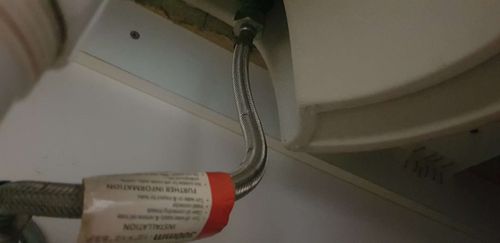

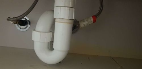

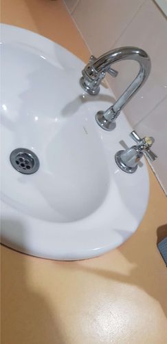

Attached are the images. Hopefully they will help you to tell me, what I can do next ?
The water cannot leak in such case, can it?

They appear to be standard taps which will have a tap valve washer inside of them. You should grab everything you need before starting. That would include a tap valvemulti-grip plierstap spanners and thread tape. You might not use all these and un-used items can be returned to the store. I am reasonably confident it will be a stuck tap valve and opening the tap will be able to confirm that for you. If it isn't, then a plumber will be able to sort the issue out and diagnose why the water is not flowing.
There is no isolation valve under the sink to turn that tap off, so you'll need to shut off the mains water to the property before taking the tap apart.

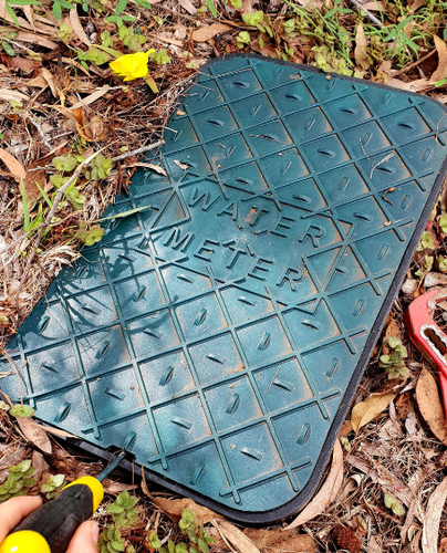

I believe this is where we can shut off main water.
And also, I cannot see any water leaked underneath the sink and around tap. So I believe there is no water leaking and harming the surface. I cannot visually see any damage to anything. My plan is: if no any damage is happening, I can wait 1-2 months because I am changing the vanities in my bathroom.

@Sugar It is always possible water is leaking elsewhere, but I find it unlikely. It is much more likely that the tap valve has seized than the water is leaking from the pipe elsewhere. Inside the cover, there should be a tap, turn it off. Then check other taps inside to make sure no water is coming out of them before continuing.
