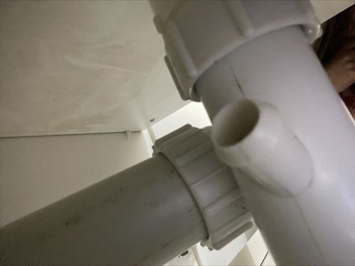

I went to bunnings and I got a Kinetic 25 mm hose joiner kit and fit perfectly in my waterdrain from the washine machine but in the pipe from the sink I squeezed it and still leak, what I can do ?
Re: How I can connect my waterdrain to the pipe?
Welcome to the Bunnings Workshop community @Ana_Alv93. It's wonderful to have you join us, and many thanks for your question about connecting a drain hose.
Let's start at the beginning. Has the barb on the sink waste been drilled out? Stick something thin like a pencil in there to check. Right where the barb meets the wall of the waste, there should be a drilled-out hole to allow water to flow into the waste. If it's not drilled out, you need to do so.

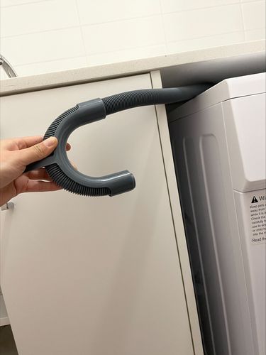

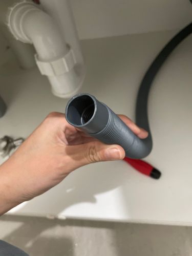

Your washing machine hose is designed to fit straight onto the barb without a joiner. I can't see what's on the end of the hose as you have the 180-degree fitting pushed right up to the end. Can you please show me the end of the hose? Typically, they have a rubber end piece on them, and this is to go over the barb on the waste. A strap clamp keeps it in place.
Since you've gone to the effort of trying to connect the hose with a joiner, I'll presume it doesn't have a rubber piece on the end, which you could have just pushed onto the barb. If so, I'd recommend picking up a new hose for the washing machine with the rubber fitting on it.

The hose in the end have a plastic structure , which is really unlucky because didn’t came with the rubber. I tried to find just the rubber in Bunnings but I couldt find anything just the set with the hose.

The hard plastic makes it almost impossible to get a seal @Ana_Alv93
Are you able to access the rear of the washing machine? If so, the hose should be connected to the back of it with a clamp. Remove the clamp and hose and replace it with one that has the rubber fitting on both ends. If you can't access the back of the machine, it would be difficult to replace the hose.
Due to the risk of fittings blowing off and dumping a whole load of wastewater into your cabinetry, I'd suggest you get a professional to replace the whole hose and make the connection for you.
