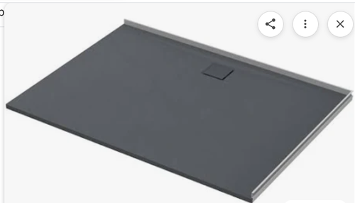

Thank you for going to the trouble of answering my question. Unfortunately, I didn't make myself clear enough. What I meant was, does the tray itself have those short upstands (30mm or so) along the two sides that go against the wall? See picture below as an example. I know that some shower trays have them and others just have a flat surface that the wall panels sit on, which then require more work to ensure good waterproofing.
Thanks again,
David

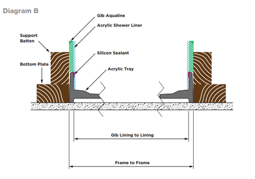

I'll grab the wall panel installation instructions from the manufacturer and check for you, @David777.
Hi @David777,
Here's a helpful diagram from the supplier and I've also emailed through the wall panels installation instructions to you. In answer to your question, the tray does have upstands.
Hi Mitchell,
Thank you very much. That's exactly what I wanted to know. Thanks also for the email.
