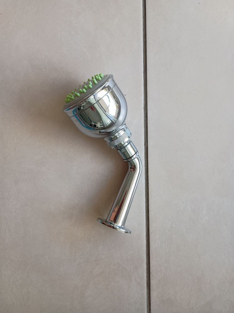

How do I attach this shower head to my 18mm plywood in my van? I have searched the plumbing section for something and just cannot find anything with some kind of nut that can screw tight while still allowing for a hose connection at the back. Please help. Thanks.

We'd need some more information about the plumbing fittings on the wall to advise further. Shower heads like these are designed to screw directly onto 1/2-inch threaded plumbing on the wall. So, you'd need something like this Brasshards 15 x 40mm Chrome Plated Brass Male Female Extension mounted in the plywood for the shower head to screw onto. On the other side of the plywood, you would screw in a Brasshards 20 x 15mm Brass Threaded Hex Reducing Nipple, which will change the thread size to 20mm allowing a Pope 12mm Universal Tap Adaptor to screw on for your hose.

This particular shower head is generally connected to a Brasshards 900mm Tails Single Screw Outlet. The tail as it's referred to is screwed onto a noggin behind the shower wall. You can install this plumbing fitting to your 18mm plywood panel and modify the bottom of the copper pipe with a Brasshards 15C x 20MI Brass Compression Union which will allow you to connect a standard garden hose fitting.
If you had something else in mind please let us know.

Thank you very much, I have now solved my problem using your solution and padding the connector to have a tight fit. I did see these in the plumbing section but I just did not know if that was what I should use. Thank you to all that gave me feedback and thank you to the Bunnings DIY community. I am building out a van as a camper and have learned so much and I wiil be so happy to offer my experience if needed.
