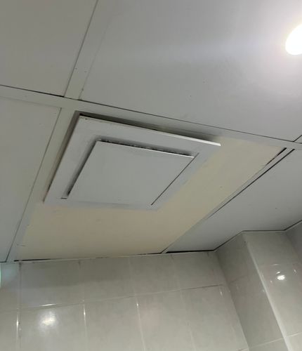

I am wondering if I could please get some advice. When I moved in my place, a ceiling panel in the bathroom had been replaced and was replaced with a brown sort of plywood - it must have been when the exhaust fan was replaced. I have tried to paint it just so it isn’t a brown panel, but would like to properly replace the panel. What product would I need to get and could Bunnings cut the exhaust fan hole into the new panel for me?

If you plan on changing the panel, I suggest taking measurements first and see if the replacement panel - Gyprock CSR 591 x 1191 x 10mm White Freshtone Diamond Ceiling Tile is compatible. I'm sorry but the store does not cut ceiling tiles. I suggest cutting the access panel for the exhaust fan with a craft knife.
I suspect that the replacement panel that is currently there was not cut correctly or positioned in place properly. I recommend taking new measurements of the exhaust fan outlet to make sure that the new cut you make is in the proper spot.
