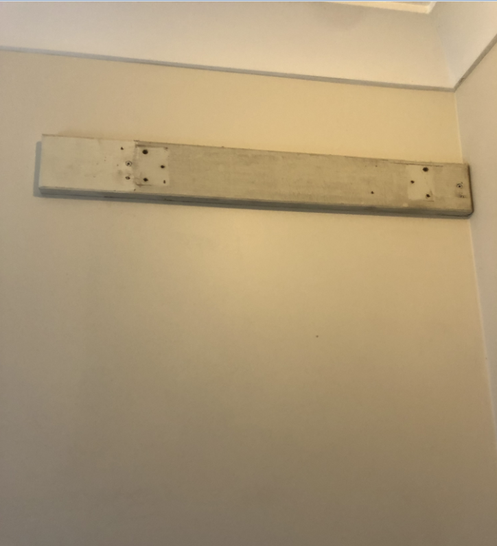

Hello all, Have moved into a rental which has an existing wooden timber batten fixed to the wall studs in the laundry (see picture below) which the previous tenants had their dryer bracket mounted on.
How should I fix my dryer bracket to this timber batten? The instructions that came with the dryer bracket say to use coach bolts*, but how would I access the back of the timber batten to fit the bolts? Could I use coach screws instead, would they support the dryer?

Thanks Eric, very helpful. Have attached picture of dryer bracket below. It takes six screws and I can attach the bracket to the wood batten without re-using the previous holes.
What I'm not sure about is that the dryer bracket instructions say to use coach bolts to attached the bracket to the wooden batten, but there's no access to the back of the wooden batten, so I can't use coach bolts.. so was thinking to use coach screws instead?
The holes in the bracket are about 6mm across and the instructions say to use 6mm x 30 mm bolts - so what you've suggested seems to be the closest match - timber screws

The only way you could use a coach or cup head bolt (almost identical) is if they are passed through the rear side of the timber batten, so their threads are exposed on the front before it is attached to the wall. That would allow you to place your bracket onto the exposed threaded studs and use nuts to fix it into position. Do the instructions seem to indicate this? I've created a rendering below to illustrate.
Having the bolts pass through from the rear side is a more solid connection for your bracket. However, the timber batten is still fixed to the studs with screws, so bolts to hold the bracket are a bit overkill. In my opinion, using coach screws would be sufficient to attach your bracket to the batten. You might like to pop another screw through the batten on either side into the stud, as I can only see one there presently.
