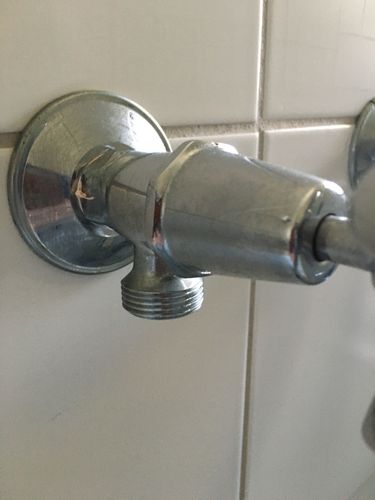

How to fix leaking laundry wall tap that connects to washing machine hose?

As taps can leak from several areas, it would be helpful if you could provide a bit more information so our knowledgeable members can assist. The easiest option would be to post an image indicating where the leak is coming from.
As the tap is permanently connected and turned on, I would presume it is not the jumper washer causing the issue. If the tap is leaking out of its body, then it would either be the fibre washer or the O ring on the spindle that needs replacing. This FIX-A-TAP Soft Turn Repair Kit includes both. Alternatively, it could be the connection and hose that is leaking. In this case, you'd look at tightening it or replacing the internal washer with one from a Kinetic 12mm and 19mm Nut and Tail Washers kit.

Hi Mitchell, the tap is turned off and still drips from the tap at hose connection

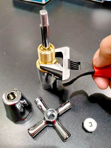

Then it is the jumper washer that needs replacing. This washer seals the water from coming out of the spout or outlet. After turning your mains water off and removing the tap's handle, you'll need to take an adjustable wrench and turn the section I've marked in red anti-clockwise. Once you remove it, you'll find the jumper washer that needs replacing. You'll most likely need some thread tap to re-wrap around the threads before screwing the upper tap cover back into position.

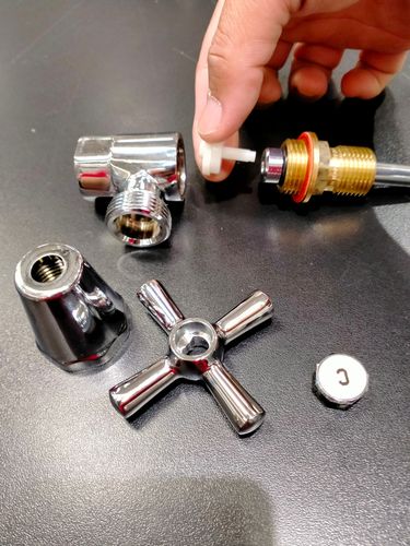

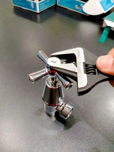

Hello @Riby
Below are a few pictures that might help. Run the sequence backwards to re assemble.

While you have the tap apart check the brass seat.
If it has been dripping for quite a while the water may have cut a groove in the brass seat so fitting a new washer will not completely solve the problem as water will still pass through the cut.
Bunnings sells stainless steel tap seats which can repair a damaged seat in a jiffy.
