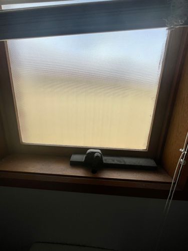

Thank you. The window doesn't have old fly screen though. It opens outward. picture here

Welcome to the Bunnings Workshop community @ELI5. It's terrific to have you join us, and many thanks for your question about installing a flyscreen.
To accommodate the window winder, you’ll need to custom-build the flyscreen so its bottom edge sits just above the winder mechanism. Start by measuring the height of the winder and ensure the flyscreen frame clears it comfortably. Here's a helpful step-by-step guide: How to build a flyscreen frame.
Once the frame is assembled, use a sill section filler to bridge the gap between the bottom of the flyscreen and the window frame. Cut the filler to tightly fit around the window winder, ensuring it snugly matches the dimensions and contours of the window frame.
After cutting the filler, secure it by pop-riveting it to the bottom edge of the flyscreen frame. This will create a neat and secure connection while accommodating the winder mechanism. Finally, fit the flyscreen into place, ensuring it aligns properly and provides a tight seal against insects. With this setup, your flyscreen will function smoothly without interfering with the window winder.

Hi, thanks for your response. I had something similar done in a different window but there were gaps around the winderhere  . How can I fix it please.
Re: How do I install a fly screen in old window
The filler piece needs to be cut more precisely to ensure there are no gaps @ELI5. To fix the current filler strip, you might like to try placing self-adhesive weather seals in the gaps.
