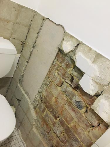

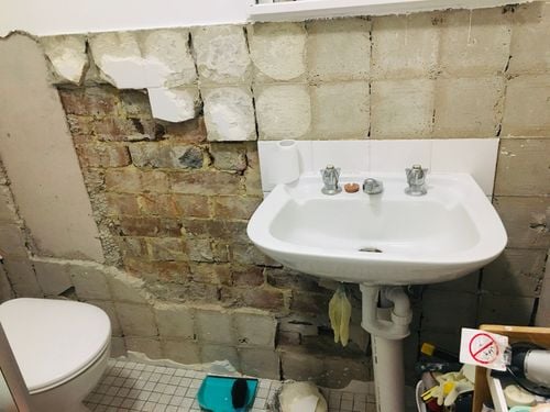

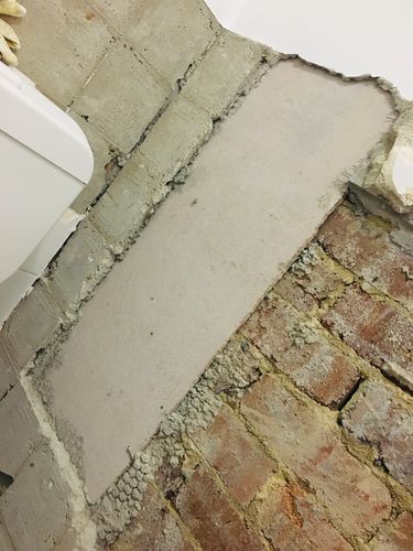

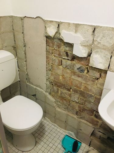

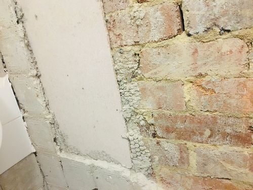

I removed old tiles in my bathroom, and i think i removed them a little bit too much (please see photo attached). Later I am also gonna remove the rest of the tiles and the basin.
What should I do to make it ready for tiling ?

It's great to have you join us and fantastic to hear you've embarked on renovating your bathroom. If the whole bathroom is brick, then I would advise continuing as you have been and remove the tiles and backing board down to the bricks. You will need to then thoroughly clean the bricks and brush on a coat of Bondcrete. You can then glue Villaboard to the bricks with construction adhesive and mechanically fix it in place with Tapcon screws. This will provide a flat surface to begin your tiling and appears to be the same method in which the tiles were first applied.
