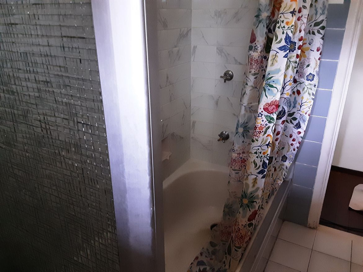

I have a bath with a shower frame sitting on the bath which I would like t20260112_133009.jpgo remove and replace with a shower curtain. I have removed the sliding doors and am left with the frame and a fixed glass frame at the end of the bathtub.

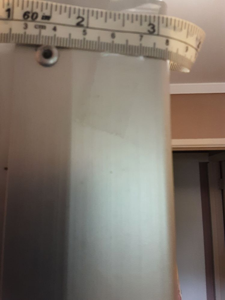

The most important thing is that your drill bit is the correct size. If you could take a photo of your rivets with a ruler or tape measure showing the scale in millimetres, we could certainly assist with a recommendation for drill bits.
