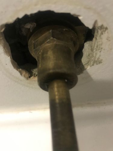

How do I remove the parts behind the handles?
I have tried a wall spanner and I have tried using WD40 and a wall spanner. What else can I do? Does this job require a plumber?

Hi @Andrea39,
If a tap spanner isn't working for you then it could need more force applied to break the seal on the old washer. As with your spout question, make sure you are unscrewing in an anti-clockwise direction. In the tap spanner kit, there is normally a little bar to use as a handle whilst turning it. If you slip a solid pipe over the handle that is longer it will be able to apply more force.
Sometimes tap spindles can become quite stuck and it requires a significant amount of force to remove them. As with @redracer01's advice in your other thread, you don't want to put too much force on them or risk doing damage.
It's a bit hard to tell from the picture, but does the nut on the spindle protrude out from the wall at all? Even if it doesn't you might still be able to get an adjustable spanner on it. That's how I got my last spindle out that was stuck when the tap spanner wasn't working.

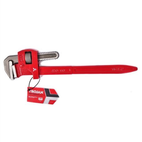

I forgot if all else fails use a pipe wrench on the main body and a few gentle taps it will loosen, however you may need to replace the unit

What do you mean by replacing the unit? Is that just replacing the spindles? I tried releasing the pressure and then using the wall spanner but it wouldn’t budge. Is it better to call a plumber rather than trying any other methods in case I destroy the plumbing. The spout and spindles would be about 20 yes old so they seem to be stuck in place. Having said that I don’t have much muscular strength as well

Re: How do I remove the parts behind the handles?
Ok first of all if doubt exist then call the plumber
The unit is the complete part spindle and main body, the spindle passes through the main body. The attached photo is the pipe wrench it has a longer handle giving you the Strength you need. Because the house is around 20 years old the fittings will be harder to get off. So something with a longer handle is needed. A plumber Will use the same sort of tool in this situation. hope this helps3c773eb4-127f-4749-915d-dfd6f9f8d35c.jpg
Hi Mitchell
your advice has been helpful. I went into Bunnings today and got a pipe wrench, hammer and long screwdriver. I managed to get the two and one spindle off and replace it.
ill have to get the other spindle off tomorrow. I might try using the pipe wrench instead of the wall spanner because the spindle doesn’t want to budge
