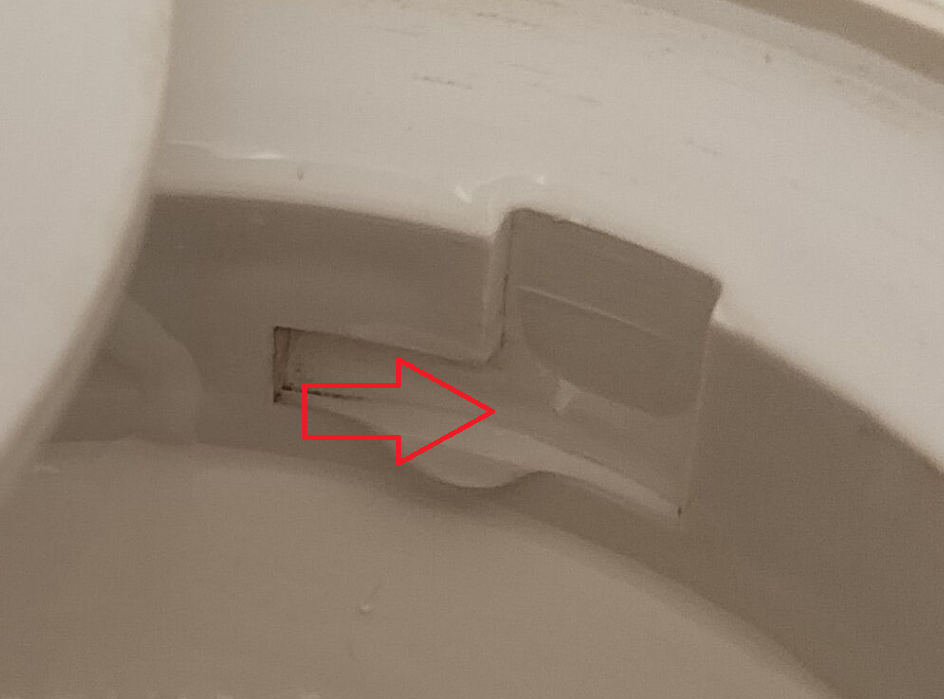

FYI this cover is not held in place by a screw. The attached photo shows how they are held in place. Turn it slightly anticlockwise then you can lift it out. However, over time they sit very tight due to buildup of dirt but you can get them moving with a bit of wd40 and 2 screw drivers. Once rotated anticlockwise, use a hook to lift it up. It takes a bit of wiggling but comes out much easier if cleaned regularly.

I'd agree that it's likely removable; thanks for pointing that out.
I wonder if @patty123456 had difficulty, as from your image, it appears that you would turn the grate clockwise to disengage it, rather than counterclockwise. Always gets me when something isn't left loosey.
