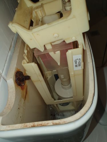

my toilet was running and checking the seat washer, it was mostly disintegrated. Went to Bunnings and bought a pack of replacements. Trying to.get the things in is so hard that I ended up breaking both of the replacements. The first one because I tried using needle nose pliers to help, and the second snapped when I was trying to stretch it in.
I tried using soapy water, soaking the washeyin boiling water to make it more pliable, and getting my wife to help, but nothing worked. Now I have a toilet that's out of order and no replacements. Frustrating!
I'll go back to Bunnings for more replacements but I need a new strategy. Can anyone help?

Which seating washer did you use? For the dual flush system, I recommend using FIX-A-LOO Seating Washer - Suits Caroma Duoflo And Thunderflush. This and one other brand are the only compatible ones for the Caroma set. The dual flush system still uses a large traditional rubber-based seating washer. It can take a lot of abuse and can be stretched much further than regular thick washers.
I can see from your photo that you've removed the top part of the dual flush mechanism. You shouldn't have any issues when sliding in the FIX-A-LOO Seating Washer. If you still run into issues would it be possible for you to post a photo of the bottom of the flushing mechanism? This will give us a better idea of what's going on. We'll then be able to offer you some recommendations on how to install the seating washer.
Please keep us updated with your progress, we look forward to seeing your cistern repaired.

Re: How do you replace a seat washer on a Caroma toilet?
Who on earth used non-stainless steel fasteners to bolt that cistern to the wall?
That looks hideous, all that rust.

@EricLthat's done it! Thank you so much. The replacement that you suggested slid on with very little effort and it has solved the problem.

@MikeTNZ  You're absolutely right! In fact I have to replace another cistern in the laundry room of the exact same type and I'm concerned about getting the fasteners off!

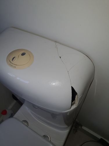

I have put in a request with the special orders desk at Bunnings to find a the replacement cistern from Fowler (Caroma?), and they should be getting back to me in the next couple of days if they can find the right one. They told me that a universal one may not be suitable because the cistern sits on the base.
I dropped the lid to the cistern 6 months ago and it broker into about 6 pieces. 👍 So if I can't get the fasteners off do I need to attack it with an angle grinder?

Hi @Bluetooth
Your toilet is either the Fowler Regent MkII or the Florida MkII. Both these toilets are close-coupled toilet suites. Their cisterns sit on the pan and they're not connected by a plastic flush pipe. I recommend changing the whole set as it is more cost-effective in the long run. Caroma purchased Fowler back in 1997 and they've discontinued a lot of the toilet suites keeping only the most popular ones in the market. I recommend the Caroma WELS 4 Star 3.5L/Min Luna Back To Wall Toilet Suite as a replacement for your current set.
