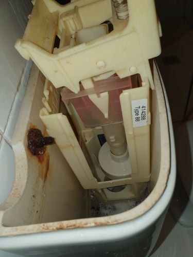

my toilet was running and checking the seat washer, it was mostly disintegrated. Went to Bunnings and bought a pack of replacements. Trying to.get the things in is so hard that I ended up breaking both of the replacements. The first one because I tried using needle nose pliers to help, and the second snapped when I was trying to stretch it in.
I tried using soapy water, soaking the washeyin boiling water to make it more pliable, and getting my wife to help, but nothing worked. Now I have a toilet that's out of order and no replacements. Frustrating!
I'll go back to Bunnings for more replacements but I need a new strategy. Can anyone help?

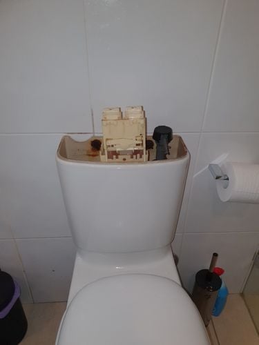

@EricLThanks for your suggestion. I'll consider a new suite. Bunnings special orders got back to me and let me know that Caroma has a replacement cistern (smaller size, but apparently it will fit), for a cost of $1,041. So clearly that is not an ideal solution, cost-wise.
It is frustrating that that a cracked lid on a toilet in the laundry will now result in over $1k spend for a new suite installed by a plumber. I wish there was some way to repair it.

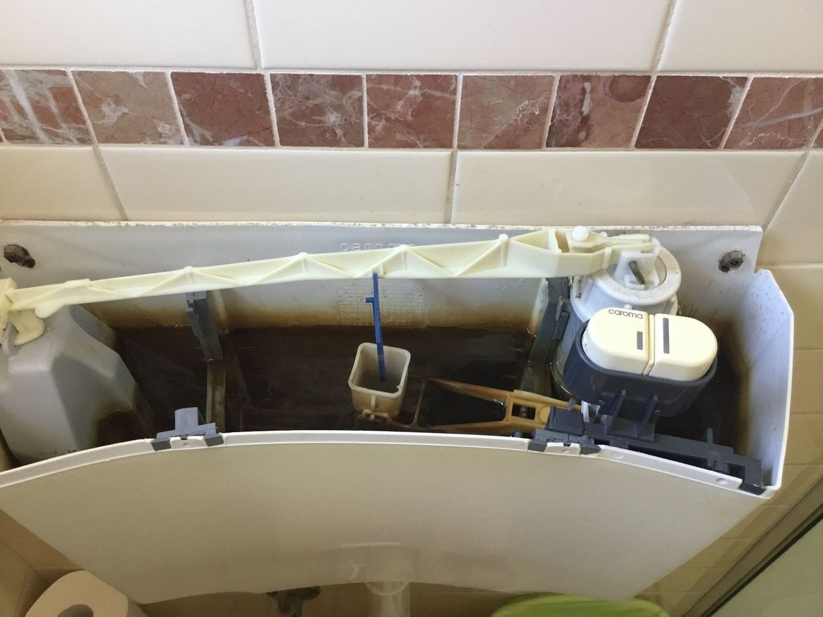

I returned to Bunnings with my micrometer and eventually bought the fix a loo seating washers which suited caroma duoflo and thunder flush and they fitted more easily and sealed almost immediately. They are more expensive and unfortunately many of the washer packs are just labelled with the name of the cistern with no other description of other possible products or product options that may fit that cistern. The duoflo and thunder flush washers are of a larger diameter (wider) and are quite pliable in their composition. It’s a pity that there is not a more comprehensive list of washers that may fit certain cistern systems. Caroma Internal
Caroma Cistern
