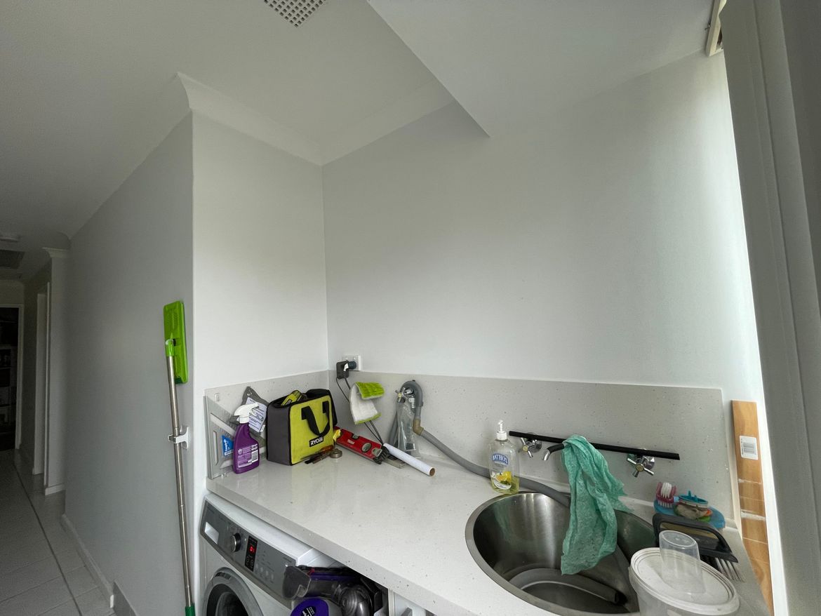

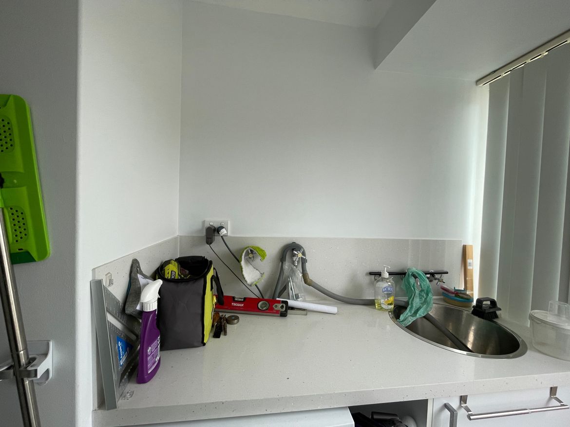

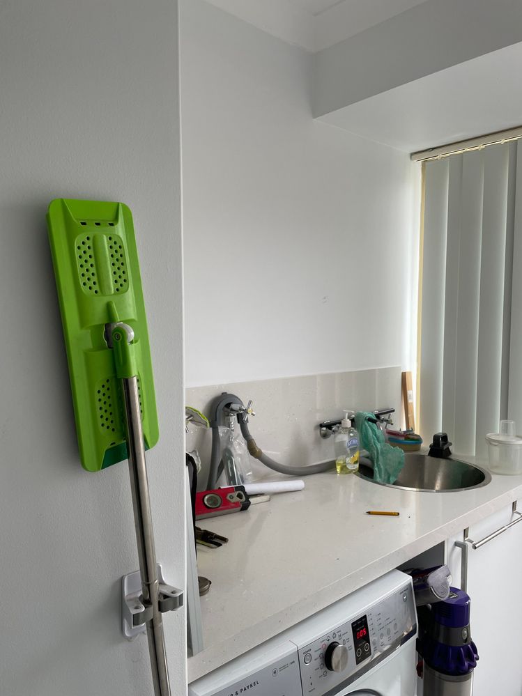

Laundry is at end of hall - not a separate room. Has stone bench top with sink. Front loader washing machine under bench. It is only a small area so want to put up corner unit and another unit above bench. Cupboards 600mm and 900mm width = total 1500mm. Brick wall.

Is this the width of the hall? (Any chance of a photo or two?)
You want a corner unit plus another unit above the bench. Is the corner unit going above the bench as well?

Will wait for some pics and modify my ideas then.

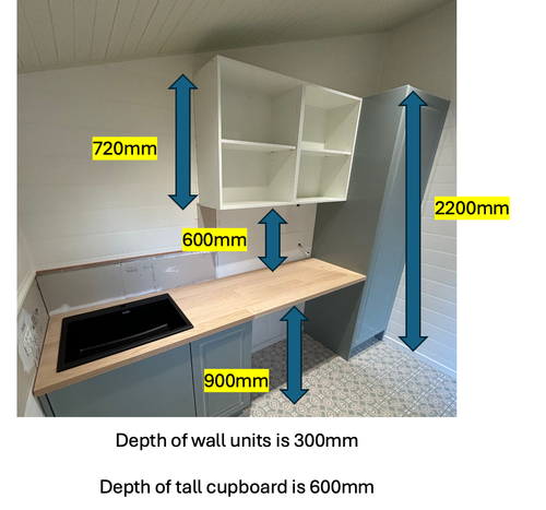

Hi @Karina2 I'm actually assembling laundry cabinets at the moment. Please find below the standard dimensions which I hope assists. As @EricL mentioned, around 600mm is a standard height, bit there is nothing stopping you from altering this to suit your needs. Making mockups out of cardboard boxes and sticking them to the wall might also help to give you a better understanding of the impact and what works best.

Brick wall not stud wall.
Thank you Nailbag for your photo with dimensions in. The power point (top of) is 400mm high. I marked the wall under bulkhead at 62cm down which is also 60cm from bench top to that mark (it's in pencil so hard to see but roughly above handwash container). We have heavy duty fittings to fix to wall (as advised) as is into brick wall.
Luckily is recessed so I wont hit my head or hip. I appreciate your advice. I'll check again for further advice but thinking 500 -550mm may work for me.
