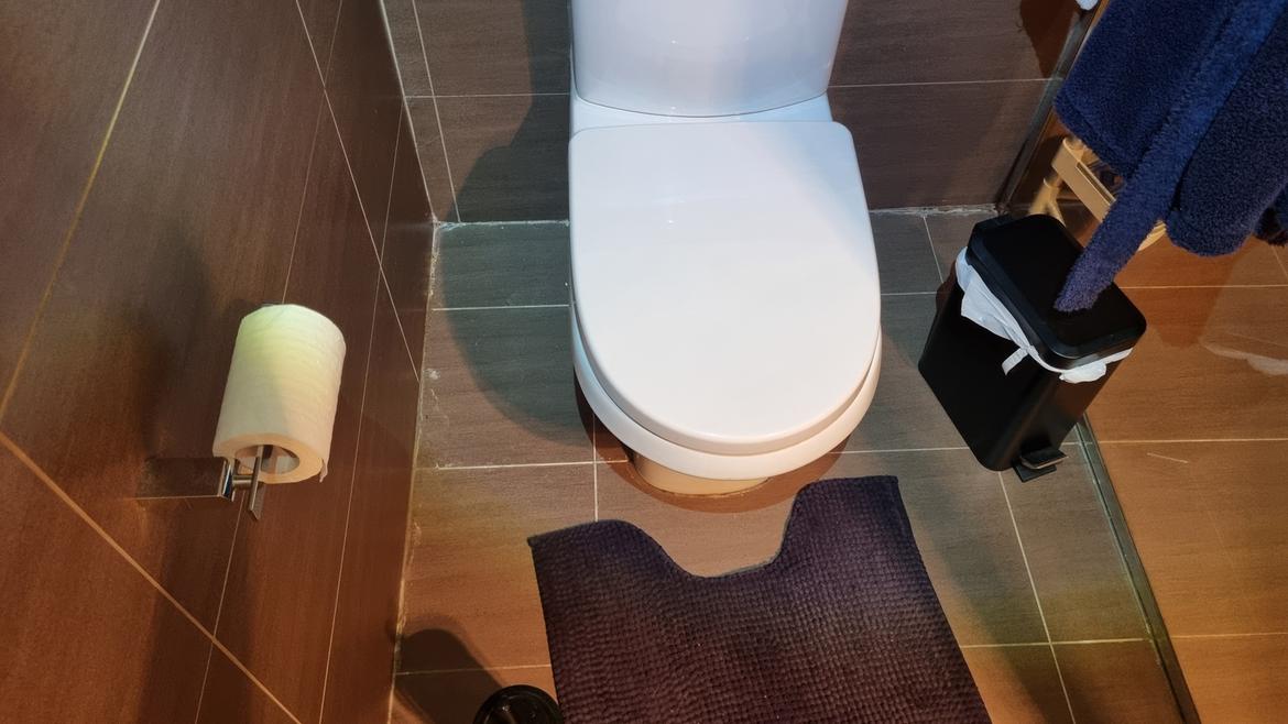

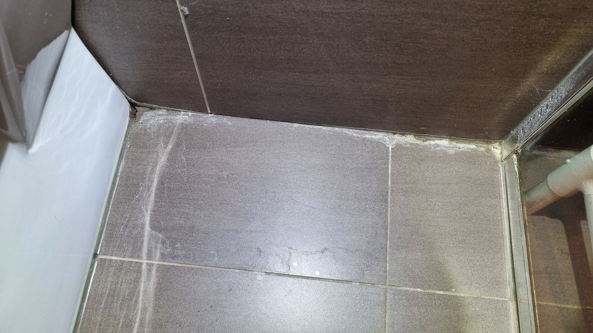

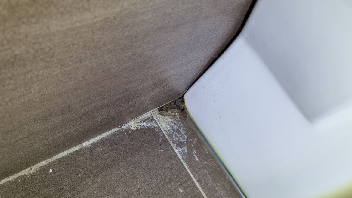

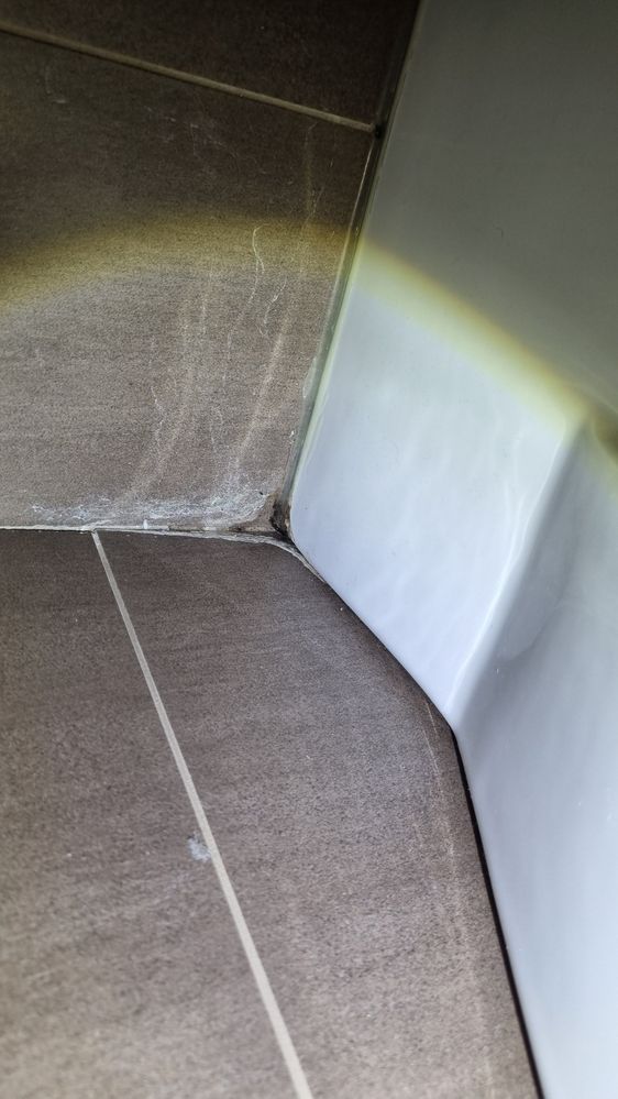

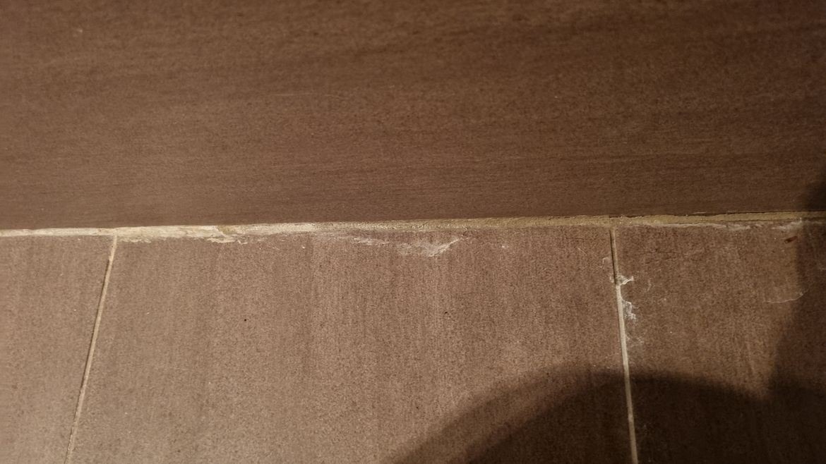

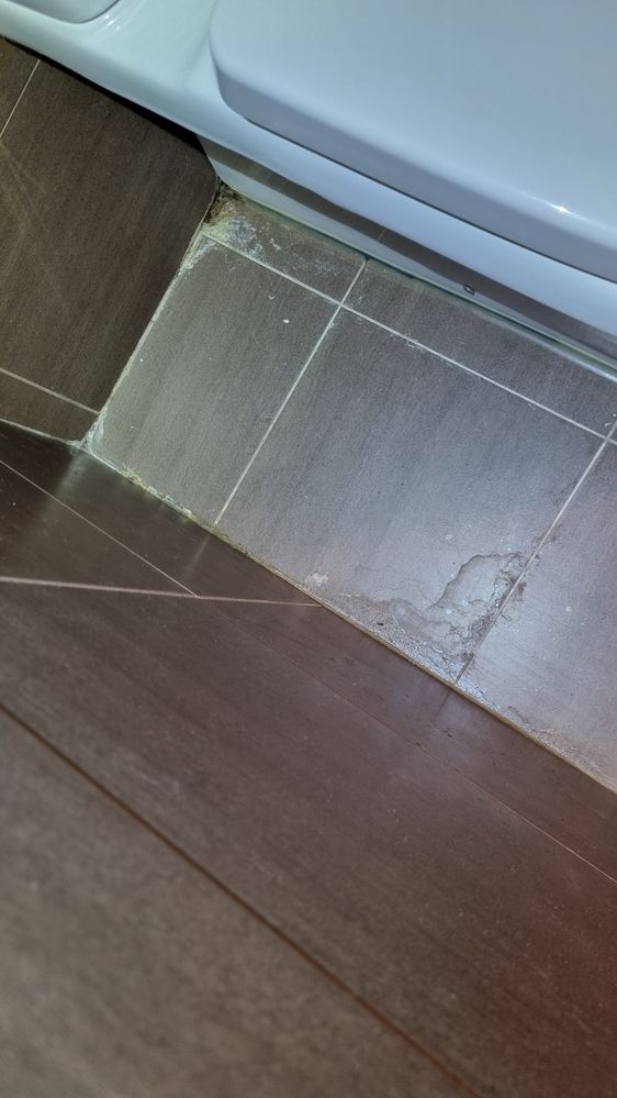

Here are some photos, which might be hard to decipher, so I'll do my best to add descriptions.
Rear of toilet, silicone meets tiles, appears wet and some brown growth/gunk build up. (photo is upside-down)
Rear of toilet, same gunk on other side against tiles, white residue on tiles, shower frame on right.
Another pic of the wet gunk on the toilet at rear where tiles join wall/floor
Tiles along wall (not shower side) and floor where the wet grout was first noticeable.
Rear/side of toilet adjacent to wall (opposite side from shower)
Holistic view of space

This will require a bit of an investigation on your part. It looks and appears like that there is a leak near your toilet and shower enclosure, But I suspect that it is condensation forming on your walls during hot showers and the water gathers at the bottom forming small pools creating that small calcium build-up. I propose cleaning that section of the tiled wall with CLR 750ml Bathroom And Kitchen Cleaner and scrapping all of the dirt and calcium build up in that corner and along your shower enclosure.
Your goal is to do a leak test, normally a leak will be continuous and will present itself as a small puddle growing bigger. If your toilet pan was leaking trust me, you would know by the smell. If the leak is coming from the cistern your inlet valve would be constantly hissing during the night as it tries to fill up the cistern. However, occasional dampness or wetness could be the result of water just getting trapped in that section and having nowhere to go. If the leak is coming from your shower assembly, then it just needs to be sealed with silicone.
Once the area is clean observe the formation of water before, during and after someone has a long shower. If water appears before someone has a shower, then it's possible that there is a leak coming from the toilet.

It kind of looks like your toilet is leaking, that build up against the actuall toilet and the colouring makes my mind head towards that (or cleaning products). I would do the same steps as @EricL has suggested in cleaning it up spotless and then keeping an eye on it regulary for a week or two. It looks like a slow leak with that discoloration (If it was faster then you would end up with a noticable puddle)
I was actually thinking it could be the rubber seal that sits under a toilet perishing or being crimped on install but I do not know for sure about the different models that have that. If the leak persists my first step would be towards a plumber to have a look at the toilet itself. In particular the footing and how its sealed (silastic around the outer edge wouldnt fix it)
