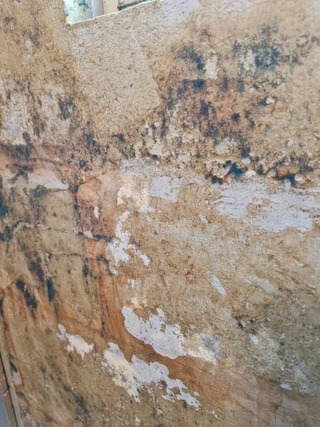

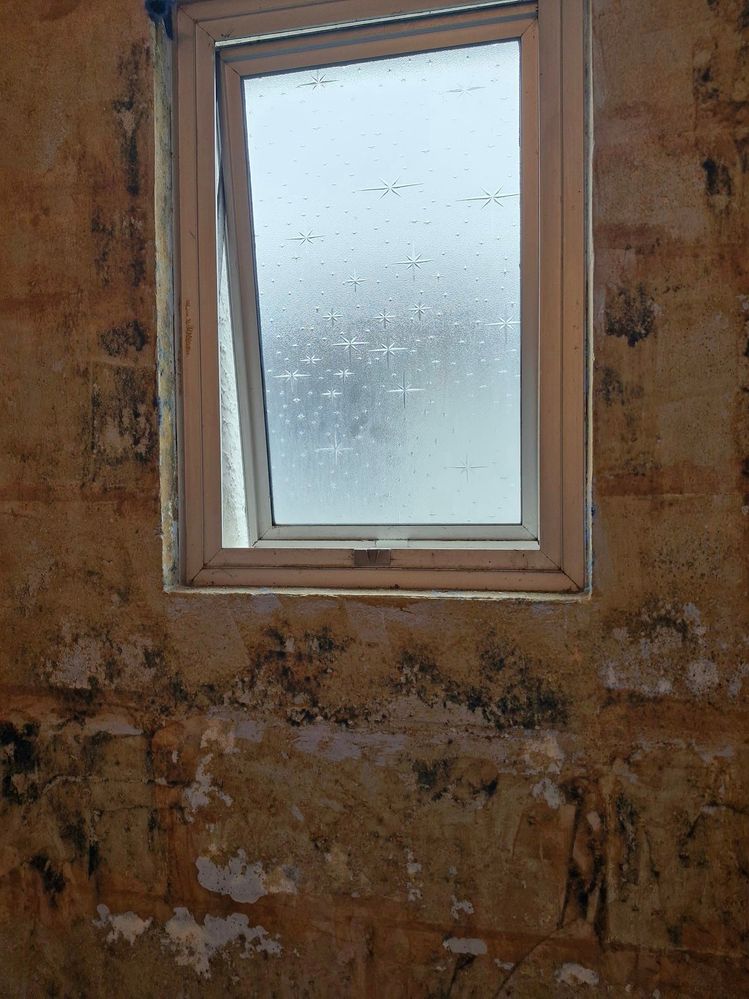

I have a single concrete block back wall which is in our toilet. It's from a 1970's house and of all things it was covered with carpet (the parts in the photos that look like mould are in fact the remnants of the blue carpet). I have since removed the carpet but the surface is very rough. Someone also mentioned that it might be worth getting it asbestos tested as the glue used might contain some? I was hoping for some advice on how to make this wall look good. Do I cover it with gib or mdf or something like that? If so, what would be the best way to do it?

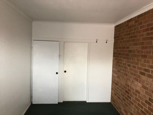

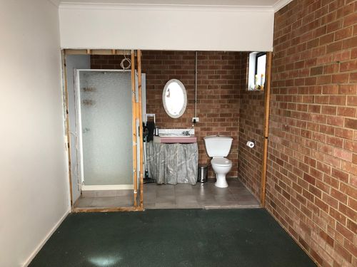

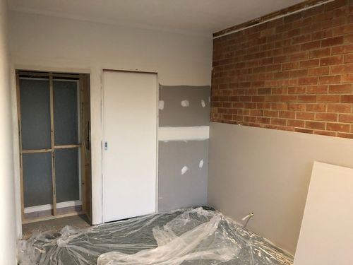

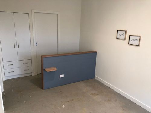

Hi @Nesian as suggested by @JacobZ I would go with fixing directly plasterboard to the wall. This can be achieved without the need to batten the wall which will raise the issue of any possible asbestos. It's also a much simpler solution. See photos below of a similar project where I covered and old brick wall, when renovating a decades old downstairs bedroom.
