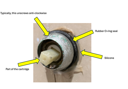

The image below is the breakdown of what were are seeing here.
1. The silicone prevents water entering behind the tap fitting into the wall and has no bearing on the ability to remove the chrome cover.
2. The rubber o-ring in this situation does very little other than provide a soft barrier to the mixer handle during operation.
3. The centre square stalk is part of the cartridge which would be gripped to remove the cartridge once the outer chrome ring is removed.
4. This outer chrome ring is very corroded and needs to unscrewed anti-clockwise to be removed to allow the cartridge to pull out. It will need a pair of multi-grips or a plumbers pipe wrench to remove it but at the risk of damage. Most likely cosmetic only.
My advice is to get a plumber in to remove it and source one of the countless cartridge designs through the trade plumbing suppliers if not Bunnings themselves. the plumber will have the wrench required to remove the ring hopefully without damage.

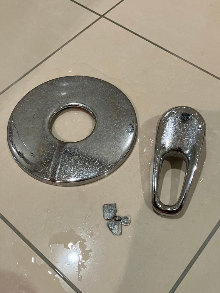

Please find the photos attached of the parts that have been removed including the tap head.
I have two showers in my bathroom, one side which I cannot use due to the leaking shower faucet, I am currently using the other shower which works fine.
Is there a way to prevent water from leaking on the affected shower faucet, in essence turning the tap off on one side, without impacting the other shower?
shower tap head, backshower tap head, backshower tap head, frontshower tap head, front

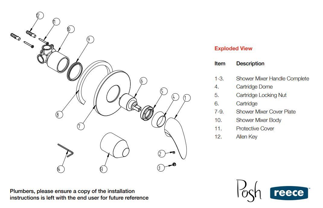

Reece Posh Bristol MK2 Shower Mixer Tap Chrome is one that kind of looks like yours.
POSH BRISTOL MK2 SHOWER MIXERS in particular page 3 has what the inside of your tap possibly looks like.
It looks like you have removed (or its snapped off) up to part 5 (lock nut) from the tap.

I had a look at the diagram and by the looks of my current situation, I think I removed part 1-3.
The plate (part 7?) was loose so I've already removed that piece.
In reference to the diagram, I think I need to remove part 4 to reach part 5.
