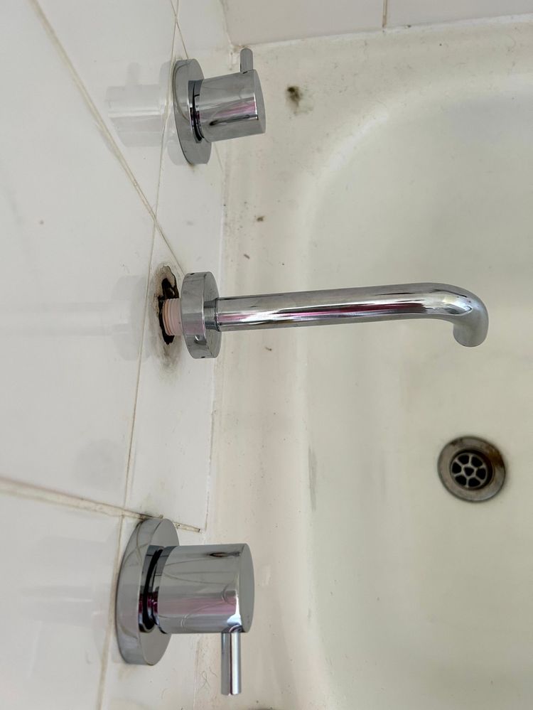

I am replacing tired tapware in a bathroom and have an issue with the spout being too proud as the depth of the Mondella Resonance spout is very shallow.
Can anyone recommend an appropriate flange or trouble dome that would do the job neatly - cutting the breech isn't my preferred approach.

If you are after a flange to go into that gap you can use a Fix-A-Tap trouble dome. You'll need to order it at the special orders desk, I've placed an image below so that you can show it to the special orders team. Your other option is to make your own cover flange from a Holman 50mm PVC DWV Push On Cap. You'll need to drill into the middle of the cap using a Craftright 7 Piece Flat Spade Drill Set on slow speed to prevent cracking it in half.
Once you've drilled through, you just need to sand the surface and then wash it with soap and water. I then propose spray painting it with Rust-Oleum 340g White 2X Ultra Cover Paint+Prime Gloss Spray Paint. The best part is that because it's plastic it will not rust and stain your tile.

Thanks for the reply. Perhaps there is something that has crisp 90 degree profile in brass / chrome like the taps / spout?
Hello @Barracuda (Murray)
There is the option of painting the PVC in shiny chrome if you want to match the spout. I propose having a look at White Knight 300g Super Chrome Spray Paint, just make sure to use a plastic primer before using the chrome spray. The only other options I'm aware of is the Shaw & Mason Chrome Plastic Basin Flange - 2 Pack or the Kinetic 50mm Dwv Raised Cover Plate. If I find anything else that's compatible, I'll post it here straight away.
