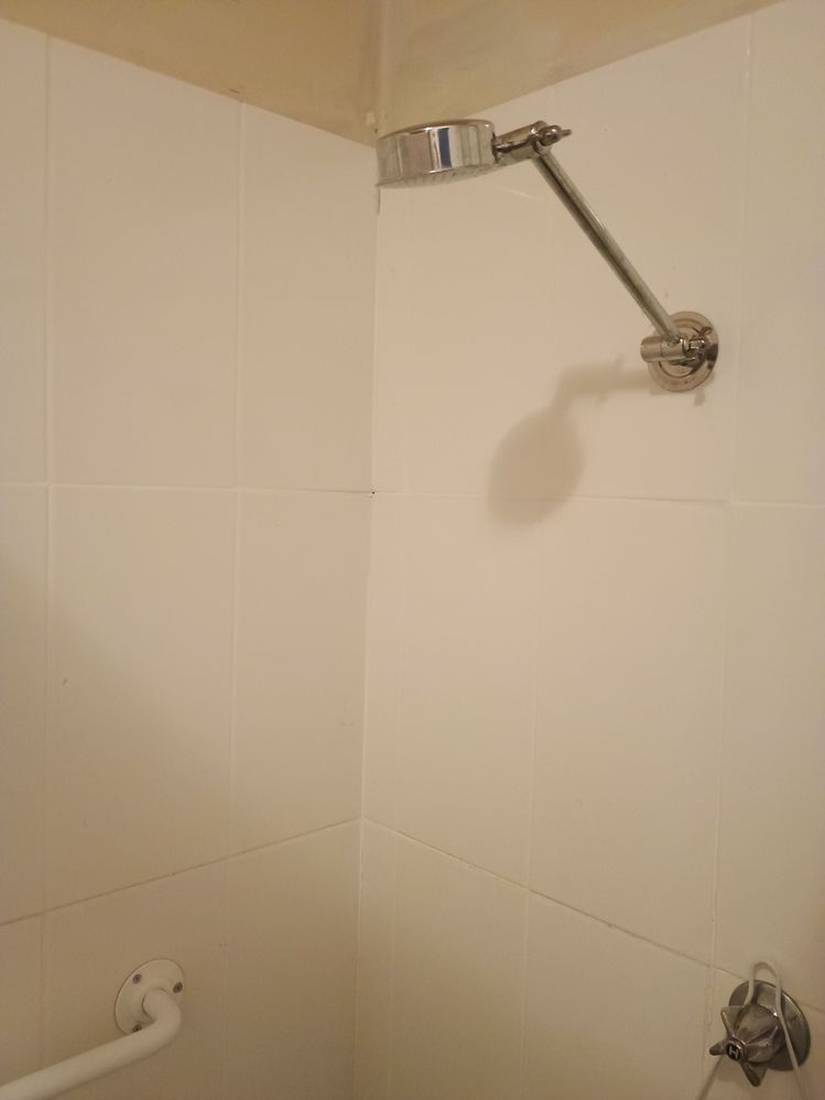

I would like to attached a shower hose to the shower (photo attached).
Is this possible or do I need to buy a new shower which includes a shower hose ?
Regards
Gary Musgrave
Hello @GaryArmadale
Thanks for sharing your question about changing your shower head. I suggest having a quick look at this guide - How to change a shower head. It will show you exactly how to update your shower head into one that has a hose attachment to it. It will be necessary to change your shower head using the Estilo Chrome 3 Function Hand Shower & Connector Set WELS 3 Star Rated 9L/min. It is relatively a straightforward swap with minimum tools required.
The general steps will be to remove the old shower head by turning it anticlockwise. Remove the old thread tape and apply a new set before you screw the neck piece of the new shower head. Once the neck piece is installed you can screw the hose to the shower head and the neck piece itself.
