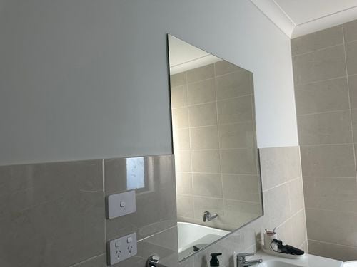

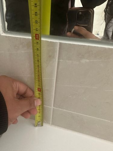

Thanks for your response. I will definitely remove the existing cabinets first before installing the mirror cabinet. The issue is that my husband thinks the height of the cabinet and the bathroom taps is not right for the mirror cabinet.
I have posted a photo showing the width and height difference between the mirror and the basin.

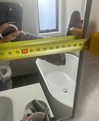

My mirror width is 90 cm wide.

If the mirror cabinet is installed with its bottom edge resting on top of the lower tiles, then yes — with only 200mm between the tap and the cabinet, it will be a reasonably tight fit. Functionally, though, the tap will still operate without any issues. The main concern is more visual than practical. Because mirror cabinets tend to have some depth, it will likely overhang the tap, which can make the area feel a little cramped and look a bit bulky. Unfortunately, that’s fairly common with mirror cabinets above vanities, especially in compact bathrooms.
You could consider mounting the cabinet slightly higher, just above the tile line, to give more breathing room between it and the tap. This would improve the visual balance without affecting usability too much. Another good option is to look for a slimline mirror cabinet — they’re available in shallower depths, which would reduce how far it protrudes and help it feel less intrusive in the space. Ultimately, it comes down to finding the right balance between function and aesthetics for your setup.
You'll be looking at the 900mm mirror cabinets, given your available width. The CIBO 900mm White Tonic Mirrored Shaving Cabinet is one of the slimmer options, measuring 140mm in depth, with the rest being around 160-170mm.
If you are particularly concerned about the cabinet overhanging the sink area, then you could have a carpenter create a niche in the wall so the cabinet can be recessed into it.
