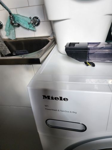

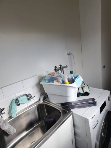

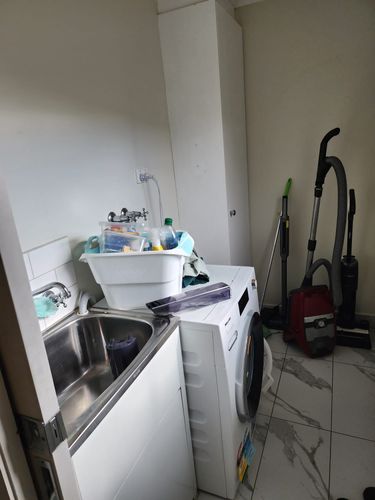

I am in a rental so limited to what I can do. I have a small laundry and wanted to add a bench too. Is there anyway that I can fit a bench top without drilling. I am sure that if I get a bench top and sit it on top of the washing machine it will probably slide down the broom cabinet side. How can I make this a bit more functional bearing in mind it is a rental and would want to dismantle it once leaving the property.

Benches in a laundy are definenty needed and so easy. I kicked myself after I put one in as I had struggled for a few years without it.
For you I would meausure the width from your sink to the wall on the far right. Subtract your washing machine plus say 40mm. That is the space you have for uying some flatpax cupboards you could use.
So standing looking at the space.
Left is the sink then
300mm flatpax Utility cupboard
Then washing machine
And depending on how much space you have between the washing machine and tall cabinet (Is that yours or was it in the laundry to start with?) maybe another of the Utility cupboards.
Then on top you can have something like this. 2200*600*26mm Practa benchtop
Bunnings cuts timber to size if you are worried about the length of the benchtop and getting it home.
One last measurement to consider is the height of the washing machine. If the utility cupbards are too short then the feet could be raised a little or some timber on top of the utility cupboards before the benchtop is laid across. Making sure you screw upwards from the utility cupbooards into the underside of the bench to stop it tipping.
You would need to drill three holes at the back of the benchtop for water and power.
Hope some of the ideas may help ![]()

I'm in a rental and have the same situation. I picked up a longer length of benchtop and cut it to length. The excess was used to hold up the end of the bench. I used small angle brackets to connect the two pieces. I previously had a dryer under mine next to the washing tub to hold up the other end. I've since moved the dryer and attached the bench to the sink tub. The house I'm in will likely be demolished after I leave, so I wasn't too concerned about attaching it to the tub. Here's a rendering I made to illustrate and a picture of my bench. Sorry about the mess.
Let me know if you have any questions.

Just remember when measuring the space you have to allow for a little bit of leeway. In this manner, you won't have to worry about the benchtop being too tight to fit into the space. If you look carefully at the benchtop render, you'll see that the secondary piece of timber sits under the main benchtop.
Therefore, the space you have for the top will not be affected by the timber you'll be attaching to the side. However, it's important that you have the correct height for the secondary piece of timber which is the leg.
One method you can use is to get some really thick cardboard and cut it to size. This will give you a nice template to use and give you a better idea of what the benchtop will look like once installed.
In regards to the sealer, it should be sufficient to cover the timber, please make sure to cover the entire area to prevent moisture damage.
